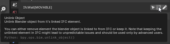

In terms of applying modifiers and editing mesh - the best luck I have had is to unlink the object from its IfcClass - see this discussion:
https://community.osarch.org/discussion/3067/how-to-fully-divide-the-mesh-into-multiple-independent-mesh-objects
@rex after you apply the modifier, try and use the following...

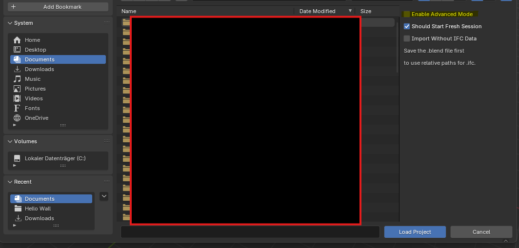

Another option you could try is loading the Ifc in Advanced Mode and ticking 'Clean Meshes'. I think on saving, this reduced triangulation would then save back to the Ifc itself.

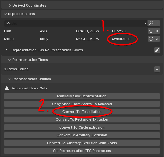

Also too, if you're wall is initially a sweptsolid, you need to convert it to a tessellation first.
If it has openings in it, you'll have to unlink it first, and then convert it back to an IfcWall for it to change to a tessellation.
