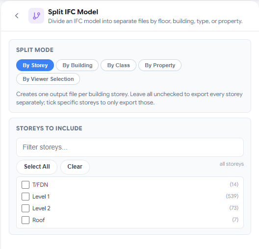

If instead we redefine "safely" based on some common heuristics like we assume geometry is the biggest bloat, and that our BIM authoring tool focuses on BIM products instead of non-rooted elements then it becomes a bit easier and we can get a relatively quickly processed file with the important stuff retained. Here's an attempt, which takes an input file and outputs one IFC file per IfcBuildingStorey. It is an IfcPatch recipe called SplitByBuildingStorey. Here's an example output when I ran it on a 250MB IFC file and took out the lowest storey. In my test of that file, which had 34 storeys, the lower levels (which were bigger) were reduced to approx 20MB each. The higher levels were smaller.
You can run it with:
ifcpatch -i input.ifc -r SplitByBuildingStorey
Note that the sum of the IFC files will very likely be greater than the original IFC file due to geometry reuse.
Let me know if it works for you and if you come across any issues :) Ping @aothms who might have a cleverer way of doing it, especially to remove the need for the disk read/write per storey - that could easily add a good 20 seconds per storey for your 800mb file just for the read/write portion of it, regardless of processing the elements. In short, maybe make some coffee while running the script, and keep a close watch in the cwd for results (first you'll see a pure copy of the file with the full 800MB, then it'll overwrite it with a much smaller version)
