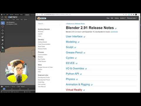

It looks like in 2.91 will implement improvement to booleans including fixes to issues with coplanar surfaces and the ability to apply booleans to collections.
Keep in mind that boolean is a modifier, so in one side say operand "A" you are only able to have one entity, but other operands "B" may be as many objects as you need, linked into a collection. You may link objects to any number of collections so i guess it will solve your "layer??" issue.
Archipack use 2 nested booleans modifiers, merging holes into a single entity and then removing result from walls.
"Exact" boolean rely on strong conical boolean and constrained delaunay, so you can't expect it to be fast, but it is expected to be way stronger than simple one.
Collection speed up may occur when operands are >= 10.
The multiple layear issue I think still exists, because I still don't know how a wall can have multiple layers, but still be or act as an object/entity?
I mean a wall is a collection of layers, when still is a just one object called wall, and how booleans create the holes?
I mean, not only merging holes needed but also merging wall layers needed?
"Exact" boolean will handle wall's layers assuming each layer is properly closed mesh part, even with co-planar faces. And yes, wall's layer must be merged into a single object.
