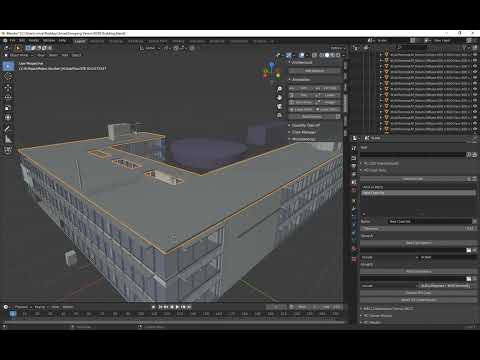

    I've also found a Youtube video from a few years ago that shows some examples:
