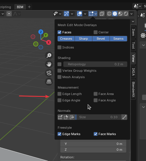

@theoryshaw wait how do you get the dimensions to show up as you model? That's amazing!
Does it also work between different elements? that would be awesome!
@jes_r When in edit mode, set the following as needed:
Ah I see, so only the one element you edit. But thanks! Will definitely use it
