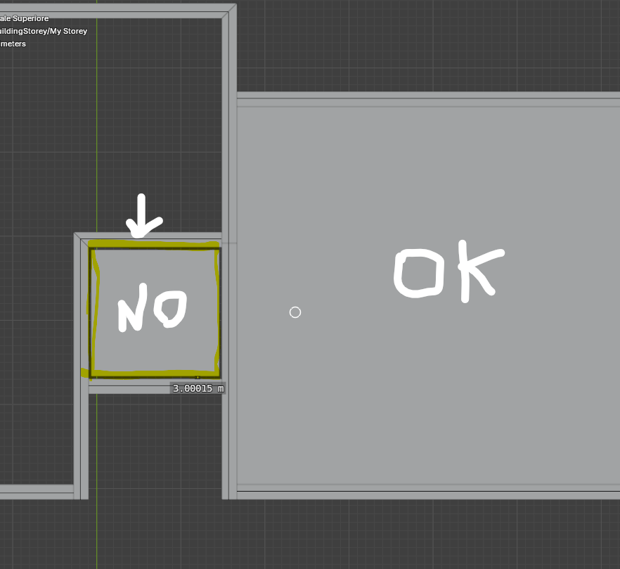

If i Generate Spaces From Walls, IfcSpace is created with 3 cm offset from walls. Is there an option to create without offset? I'm iporting the IFC in a energy modelling software (edilclima EC700) and the IfcSpace is recognize only without offset.
OK: IfcSpace created manually without offset --> correctly imported
NO: IfcSpace created with Generate Spaces From Walls tool with offset--> not correctly imported

In the meantime, i think you could try with "generate space from cursor"
Yes i did and it works!

I confirm that using "Generate Space from cursor" it does not apply any offset

In the past, there wasn't any offset, so i think something has changed recently
would a user set offset be useful for representing lining thickness where it is not modelled?
So it is not a bug but a feature request! :-)
