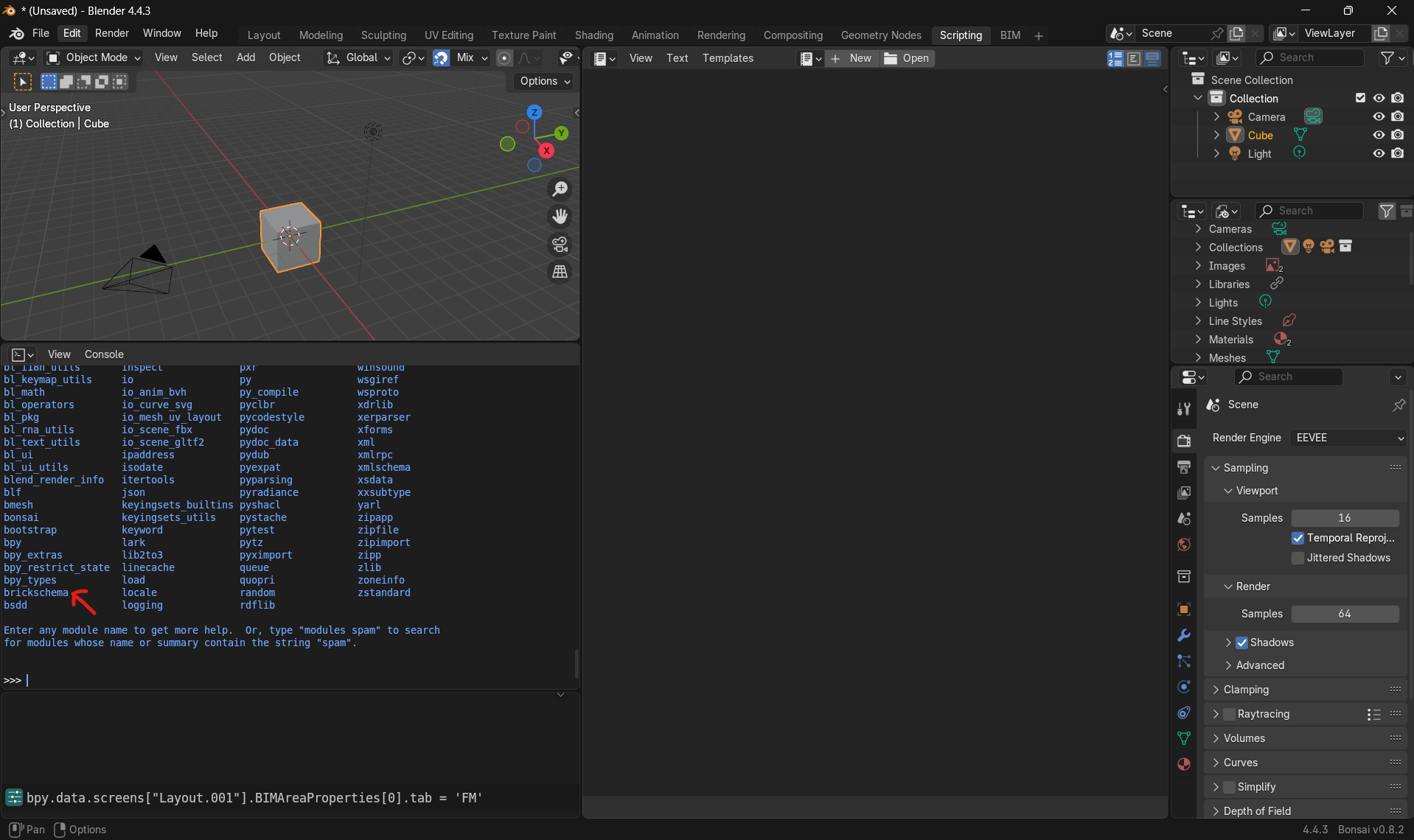

I just installed blender, bonsai, sverchok and tutti quanti and stumbled across this
I guess we're talking about this
https://brickschema.org/
https://brickschema.readthedocs.io/en/latest/
also sverchok installed all the necessary python libraries to function and also installed the new brickschema library https://pypi.org/project/brickschema/
does anyone have information about those new features ??

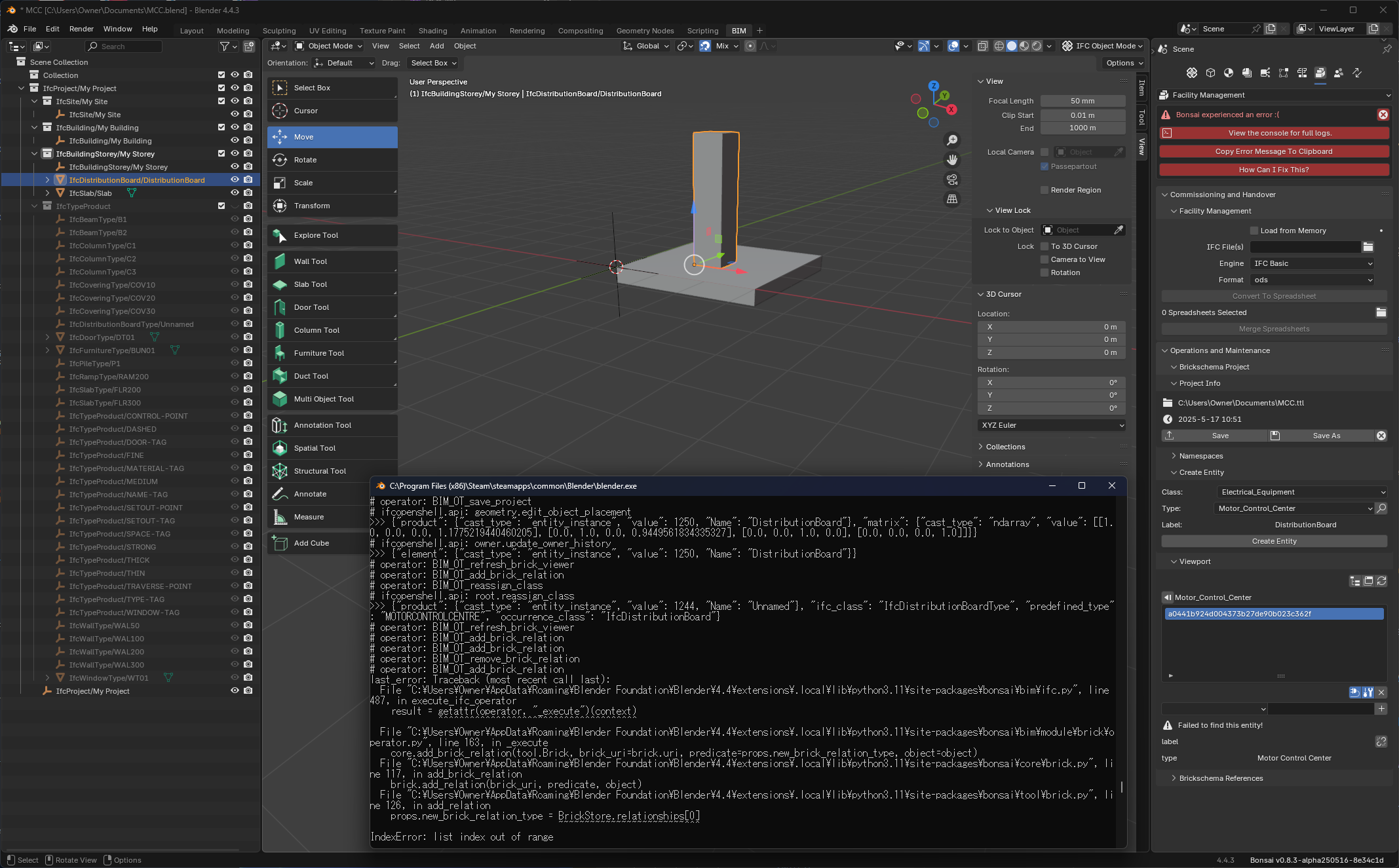

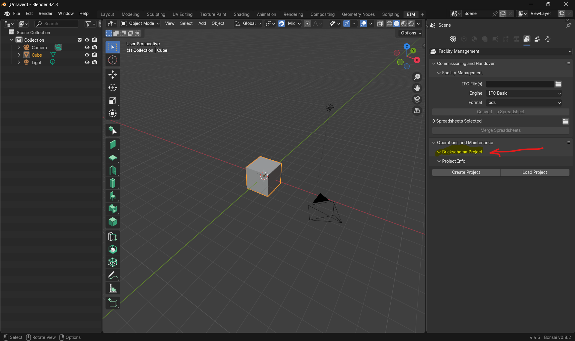

  • I didn't realize that Brick Schema needed to be installed as well as Bonsai. I assumed that because Brick Schema's entity showed up in Bonsai's Facility Management panel without installation.
    I'm struggling with IfcRelConnectsPorts, so I'm glad to see someone trying the more advanced Brick Schema, good luck.
  • This is unfortunately a somewhat unmaintained area of the code, because not many people use it. Any bugreports would be really appreciated because that would help build up our test suite too.
    For port connectivity brickschema is significantly less sophisticated than IFC.
