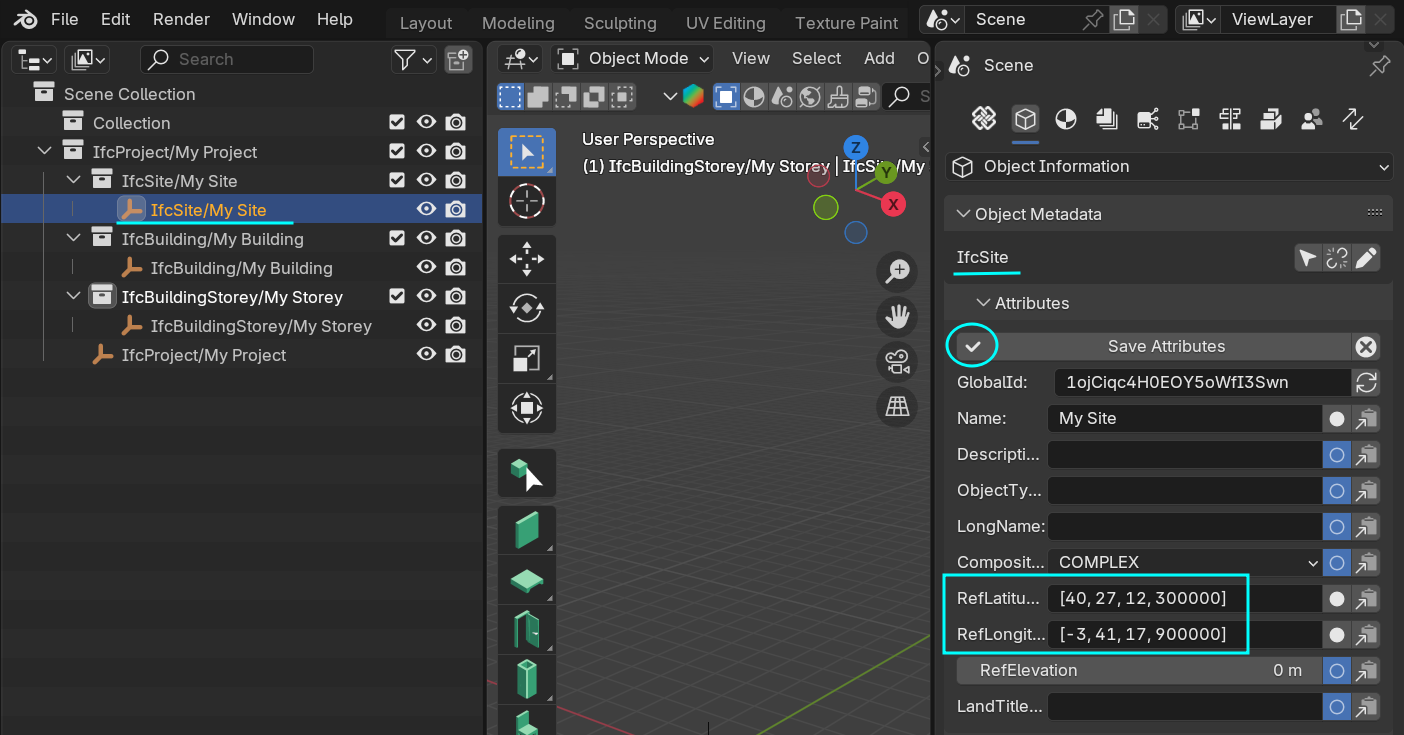

@SavyGust27 This is a rather curious way. The doc says: https://standards.buildingsmart.org/IFC/RELEASE/IFC4/ADD2_TC1/HTML/schema/ifcproductextension/lexical/ifcsite.htm
The key part is: "Defined as integer values for degrees, minutes, seconds, and, optionally, millionths of seconds with respect to the world geodetic system WGS84"
So let's say you have a WGS84 coordinate like this:
40°27'12.3"N 3°41'17.9"W
40.453418, -3.688308
According to the documentation you should use:
RefLatitud: [40, 27, 12, 300000]
RefLongitud: [-3, 41, 17, 900000]

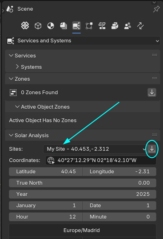

And you will then be able to fetch those in the solar analysis tool:

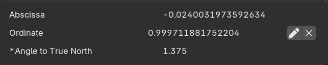

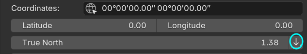

@steverugi I think so. They are kept independent. The only thing that can be imported to solar analysis from the georeferencing information is True North:
You can fetch in Solar Analysis the value clicking in the download arrow:
From the value entered in the Georeferncing->True north Panel
Incidentally , I think we have a bug in the conversion to decimal when the degrees are negative. Let me raise a PR for that :)

Now properly converting those numbers:
See PR dms2dd and dd2dms functions to use microseconds and handle negative degrees #6763
