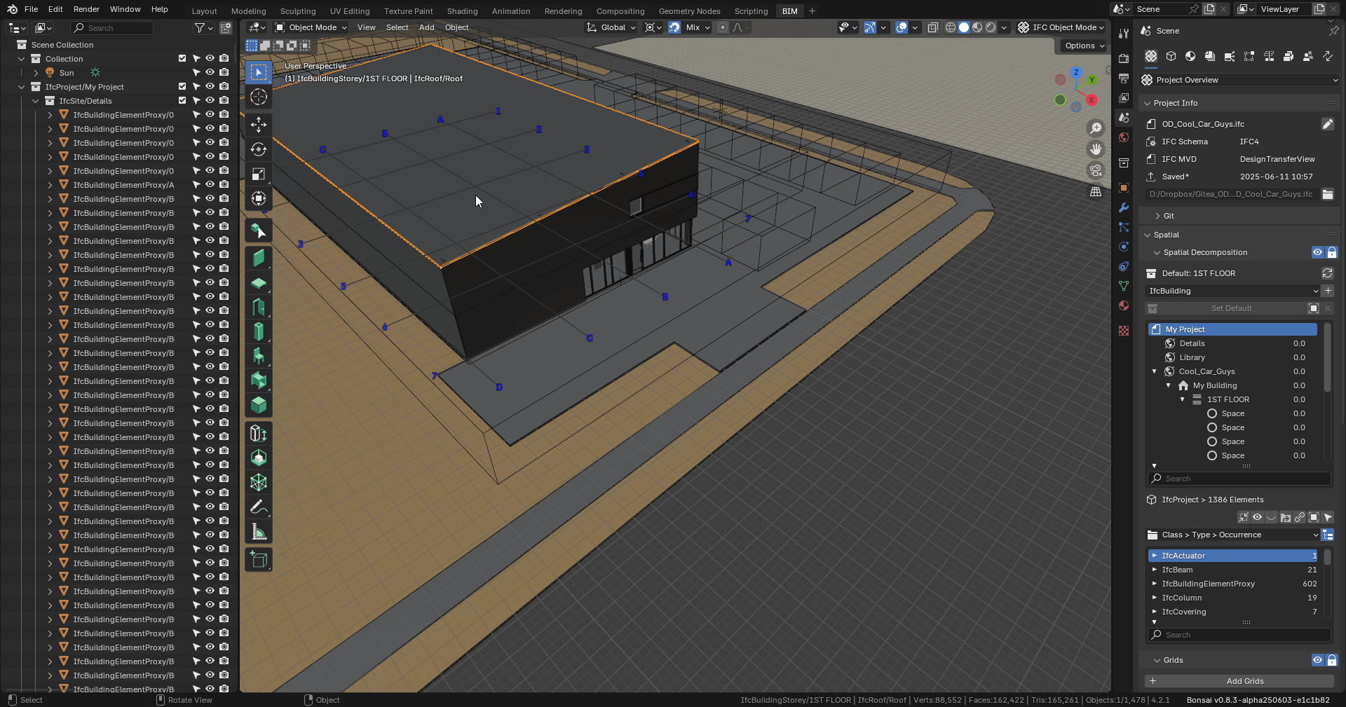

script that keeps the camera in the same place when you toggle `local view`...
My chat buddy helped write a script that keeps the camera in the same place when you toggle local view...
https://hub.openingdesign.com/OpeningDesign/Utility_Apps/commit/e267a9f2cdd553eda2179aea90094539bf11fdd6
Works in camera view, as well now.
https://hub.openingdesign.com/OpeningDesign/Utility_Apps/commit/f8449fe46dcbcac9b24c2ccc77d8ef93eed4a57c
changed plugin name to "Sticky View Toggles", and added the following functionality:
stops your viewport from jumping around when you toggle in and out of camera view (Numpad 0) and local view (Numpad /) — it stays exactly where you were looking, at the same zoom. Along the way I renamed it to fit the bigger scope, and fixed a couple cases where the zoom would snap back, including when you'd zoomed inside camera view.
