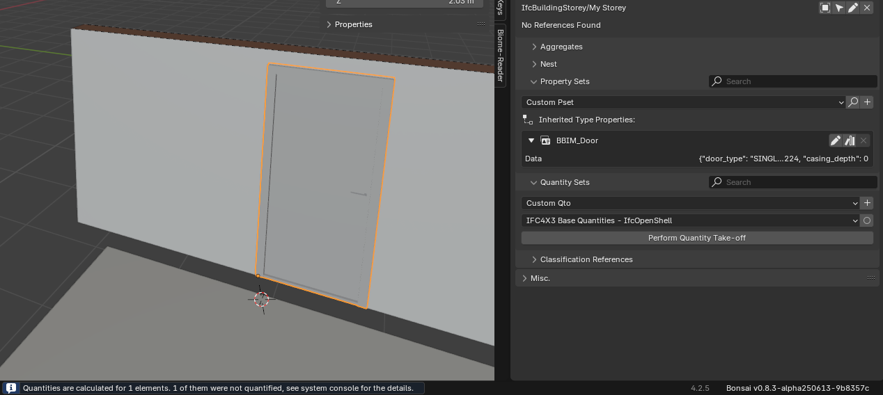

when I use IFCx3BaseQuantities-Ifcopenshell, its shown as 1of them were not quantified

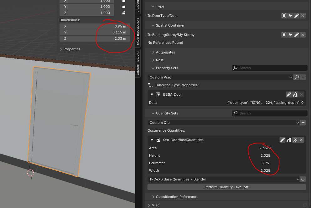

when I use IFCx3BaseQuantities-Blender, i get both width and height as equal values(in reality its not)
whats the solution, experts please advise?

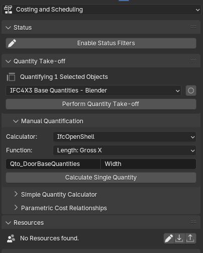

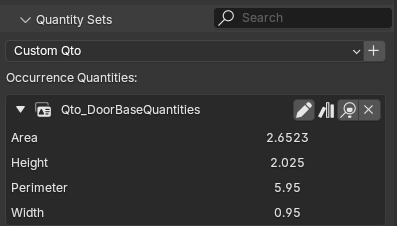

FYI using manual quantification reports correct dimension value:
