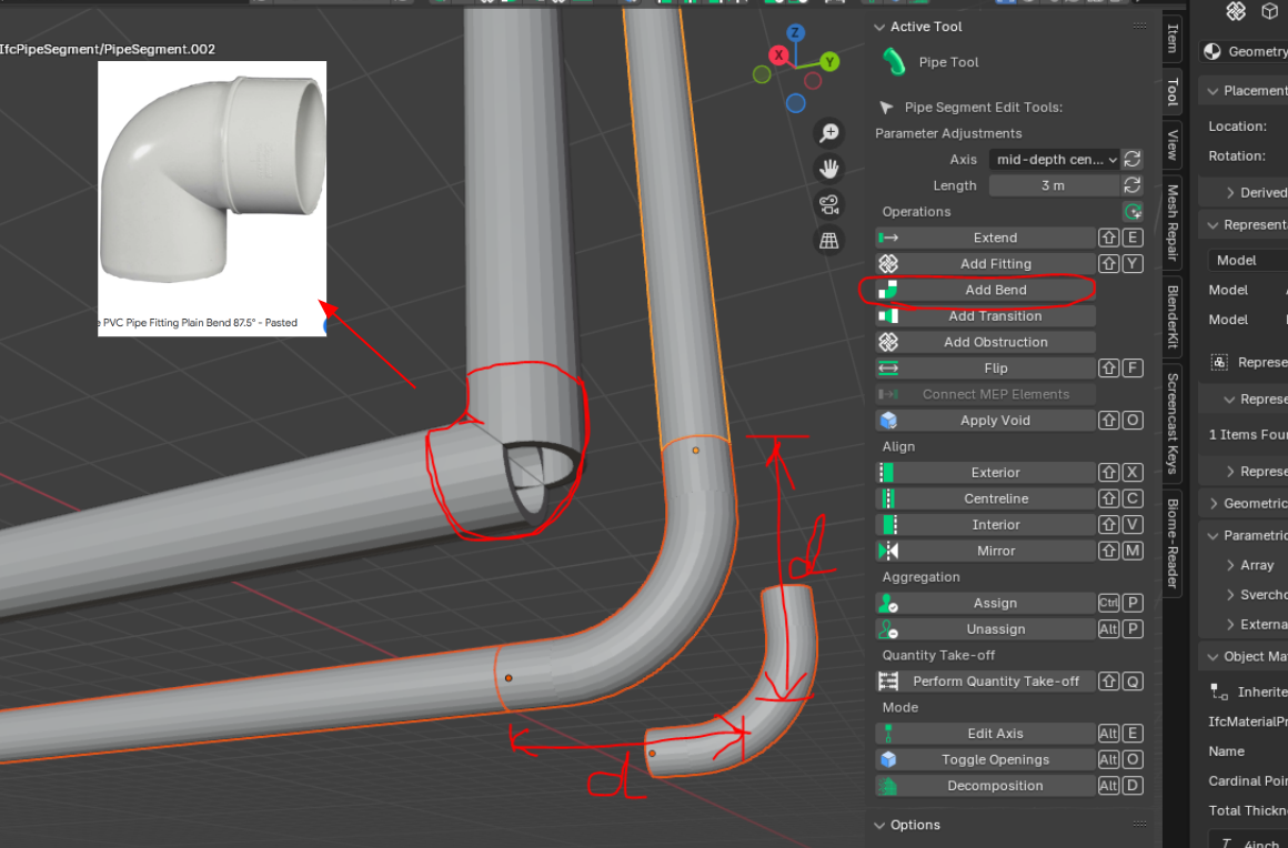

Hi all,
The default bend size generated is to reduced, Is there a way?

    I think it's still in the 'to-do' list, it would be a useful feature to have (set radius and angle like 90/45 of fitting to join segments)
    The same applies to use Tee and Wye junctions.
    Resources are eerily scarce, we need to be patient and contribute as much as possilble I guess.
    EDIT: you can add premade fittings, a bit tedious but feasible

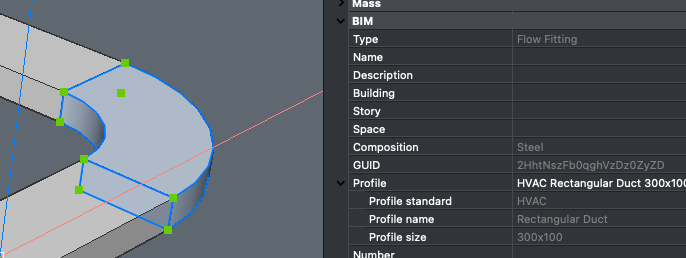

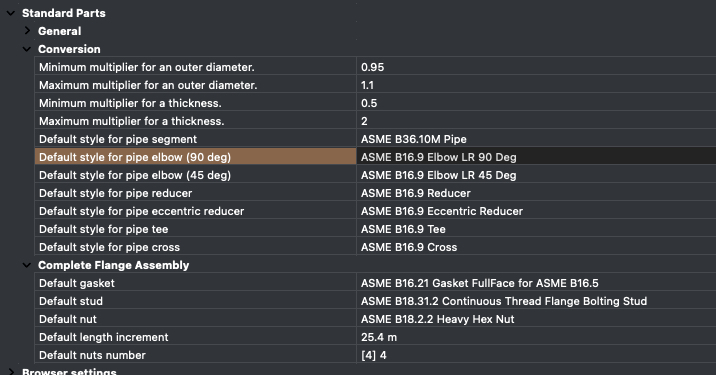

  • I think there may be HVAC standards like ..... elbow radius = 2 times of pipe diameter or such (?)
    Like in Settings of my other BIM :

    But it looks like I can't change the Standard, to EU or DIN, anymore in that latest version (?)
    But I am no more sure if it's really about global universal standard definitions .... or if these Settings are about just for adding a corespondent Geometry Object from a Parts Library (?)

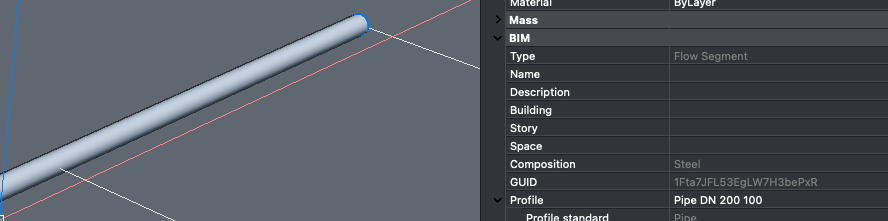

    In particular, Pipes and Elbows are classified as mechanical parts and appear to have been created for use in BricsCAD Mechanical.
    Have you tried V25 or V25.2 ?
    I am not that experienced with the MEP tools and have not IFC test exported but for me it looks like proper IFC tagging (?)
    These are Linear Solids with a chosen Profile from the HVAC or Piping Standards

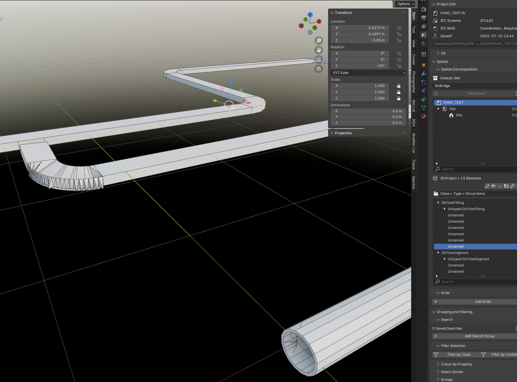

    OK, here comes the IFC 4x3 :
    IFC tagging looks OK for me.
    (Not much Info in it, mostly same in BC though. But at least adding the Profile name for the name would have been nice)
    (*) But one Fitting looks pretty messed up :)
    (*) I think the problem was that the last Segments were drawn slightly off of 90° angles. (In XY and/or Z axes) It looked like it would lock to the axis but I better had pressed SHIFT in POLAR Mode, to really lock to an axis.

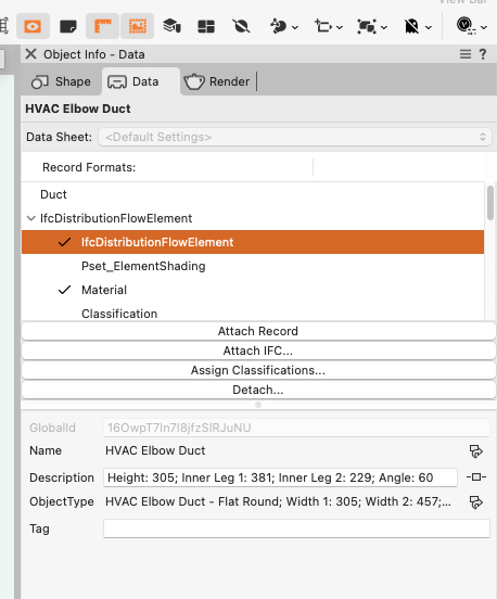

  • Hmmh, Vectorworks puts in more data, but uses "IfcDistributionFlowElement" Class .... Name/Object Type "HVAC Elbow Duct"
    But I have no clue of Duct work - beside Duct Tape.
