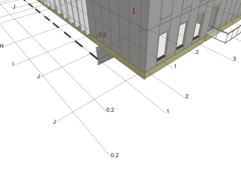

Can Blender handle grid notation "0.2"?

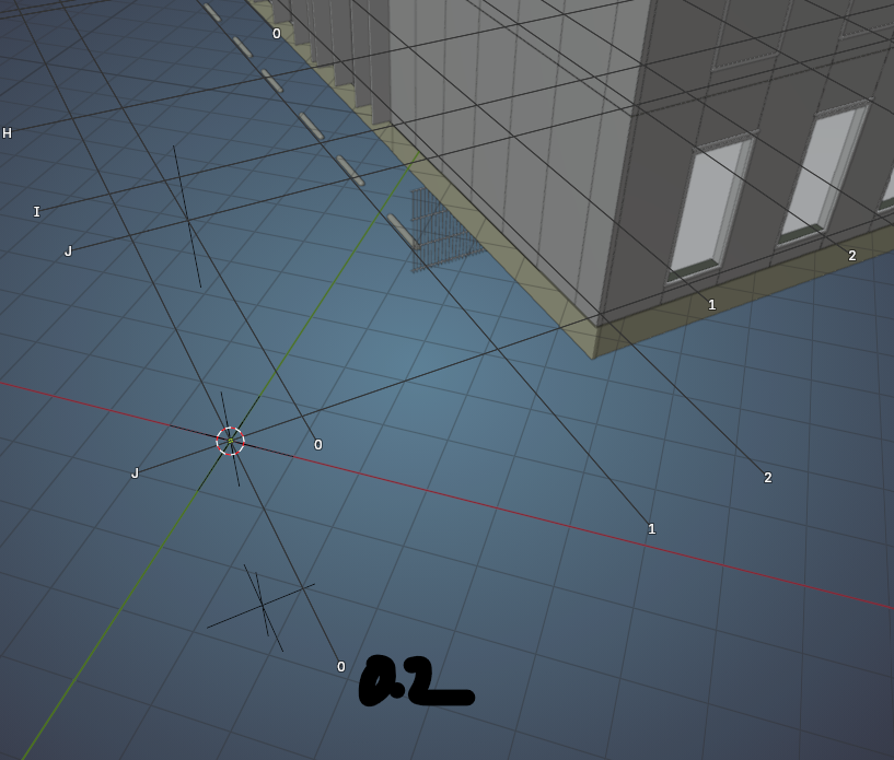

No it can't apparently Bonsai doesn't like anything after . , period included, like 0.2 returns 0, or 2.5 returns 2 I am not sure it's a bug, the - is just fine, like 0-2 you can post an issue here
0.2
0
2.5
2
0-2
I think it's a bug. With " , " it also works: 0,2
Should be treated as 'text'
