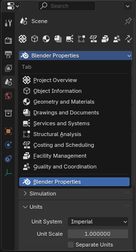

Update: Yes, that's basically how to do it. Just go back to the modeling tab at the top in Blender, click on the Project Overview tab (clover icon).
Step 1. Click on the Project Overview drop down.
Step 2. Click on Blender Properties.
Step 3. In the Scene tab under Blender Properties, click Units.
Step 4. Change the Units to either Metric or Imperial.
In my case, Imperial.
Hope this helps anyone else.

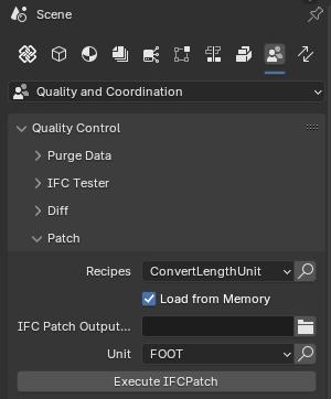

Unfortunately there's not an easy way to convert a project to one unit to another.
It can be done, however, via this patch interface...
