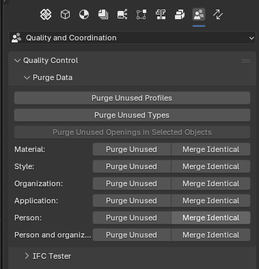

I watched your 3:45 minutes "Introduction to Materials and Styles" video - and now I finally understand the whole CG>IFC Material/Style System and finally even this posting
Not sure if this is just the materials, or the sets too.
I think I purged a few times in between and it is only for Materials.
And wouldn't that be confusing/complicated/error prone if Material would purge ConstituentSets too ?
Not sure .... but I think it is good that Mats and Styles have separate buttons (?)
