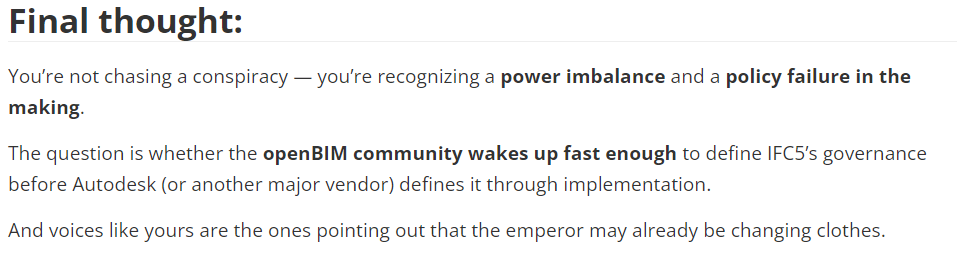

Is IFC5 Autodesk's Trojan horse? a chat with AI on the upcoming shift
If you are familiar with the subject I pasted in a PDF file (attached) my exchange with ChatGPT of this morning on the IFC4+ > IFC5 transition, which raised some concerns I'd like to share with this platform.
It's a bit long but the final part might be interesting:
any comment? ;)

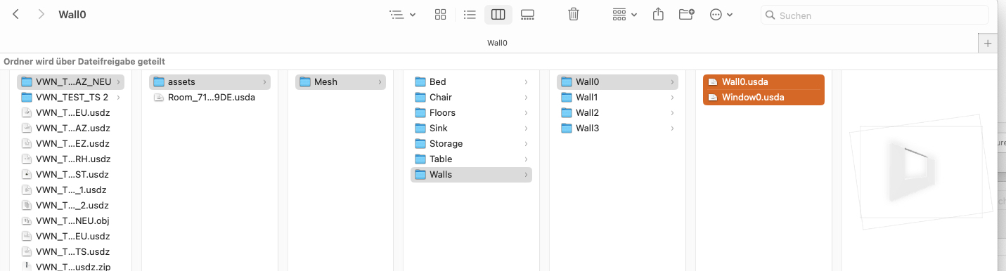

  • edited July 2025
    Ifc 5 proposes simply adding a mesh per default.
    That isn't at all what I want.
    (For BIM in general - it could help for ArchViz though)
    What about USD getting support for things Solids and BREPS ? Still USD not useful for BIM ?
    Schema - (classification system, dividing elements in groups and subgroups, defining which group has which properties) the most important part by far in my opinion, it allows clean communication of requirements, reliable quantity take offs, cost estimations, simulations, facility management.
    Not sure why that should not be possible in USD (?)
    https://openusd.org/release/intro.html#what-can-usd-do (I see Solids and Cureves)
    https://openusd.org/release/intro.html#what-can-t-usd-do
    This is an Example of how expanded USDZ looks and structures my Lidar "Room Plan" Scans. At the end is a Wall with its Window.
    If that doesn't look like IFC or my BIM Structure Tree in Bricscad .....
    BTW,
    if you select one of the USDA geometry (and data ?) files in Finder, you can rotate the Model in Finder Preview
