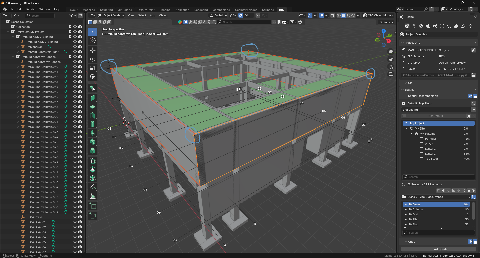

I tried opening this file on my computer, which has 10 GB of RAM, but then my computer froze. Could you tell me what might be wrong with this file

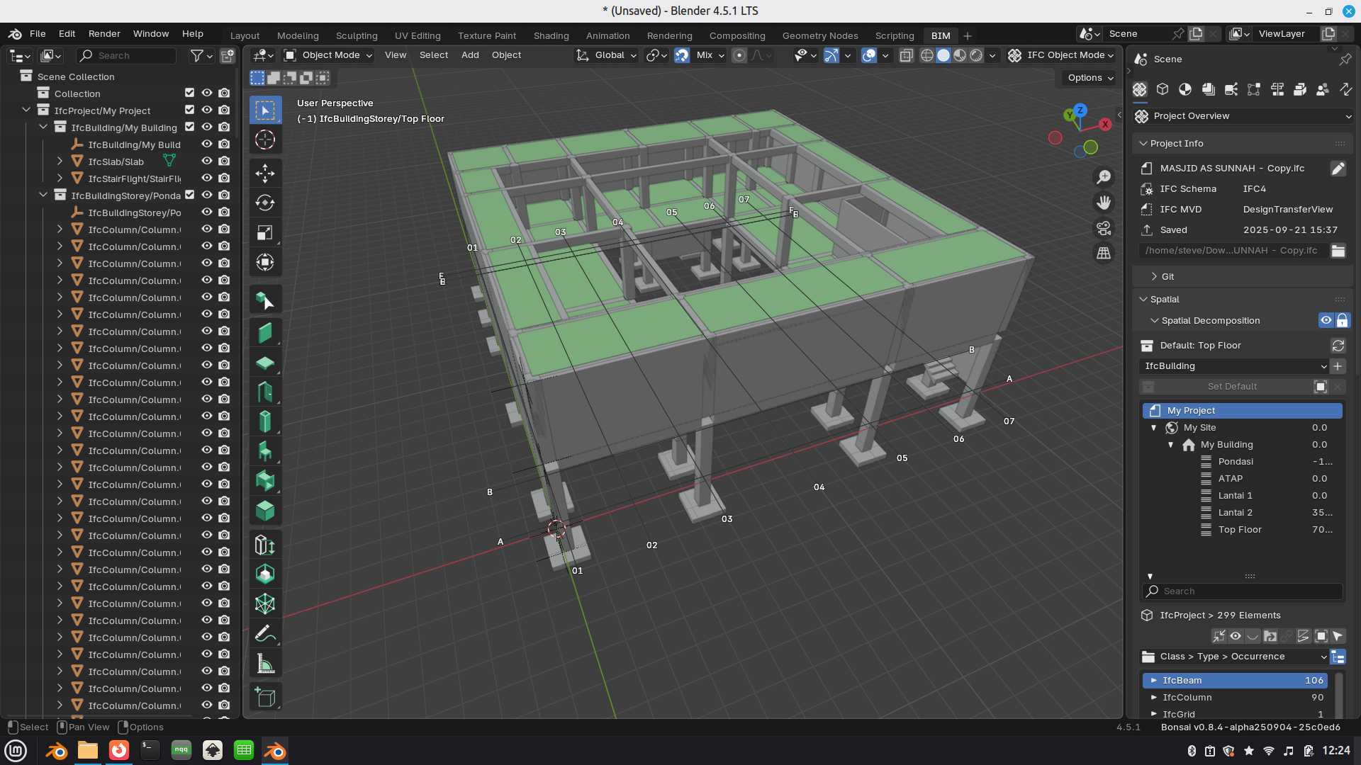

all seems OK here
Blender 4.5.1 Bonsai 0.8.4 on Linux Mint
it freezes mine too...
i would post a bug report.
@sahrul have you tried open it in advance mode and select opencascade instead of cgal?

One more data point is that it works fine for me too.
I notice that me and steverugi are running slightly older versions of Bonsai than theoryshaw from before the nightlies breakage.
I ran the file through the Bonsai file validator, and it didn't find any issues.
Open the file with advanced mode (use OpenCascade) and look at the walls in Lantai 2, use editmode and delete the "not wall studs colums whatever it is" save the file and you can open it again normal.
Walls 130 GlobalId = "1MqKqseTf3B8jm6RPLt5ds" "3x_gjgSCP0MORMARTO4JIf" "0JP6ya1DzBnBzxPY5YQRG4" "0r8dU1eNH5GQOI1bofwGgQ"

This was my mistake in drawing. Some of the walls had their Origin points positioned above, and after I deleted those walls, the file could be opened again
