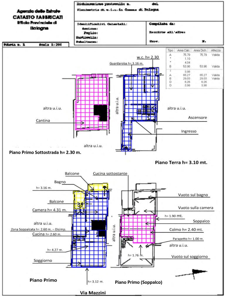

    One possible italian use case would could be to calculate the cadastral surfaces to determine the theoretical income (on which the property taxes are payed).
    An example: you have a condominium. Each real estate unit would be identified (each apartment and each garages gets a number). Then a plan of each unit should be drawn, exactly according to notorial drawings subdivision. Then each room should be classified (A to F) and poligons should be drawn removing wall gaps. Each classified poligon should remember how many rooms and their total net floor area...
    Here an example of a real estate unit with "poligon surfaces classification"
