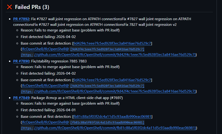

Hi @falken10vdl

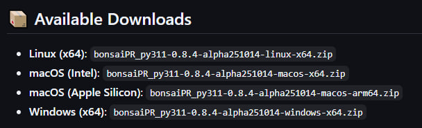

I tried and I failed to get clean links on the report. Can you help? :)
Also the whole Conflicting files: and Possible breaking commits: is missing.

It is now fixed (the variable with the link was already in markdown format so it was "markdowned" twice). I have also added some workding about the two releases:

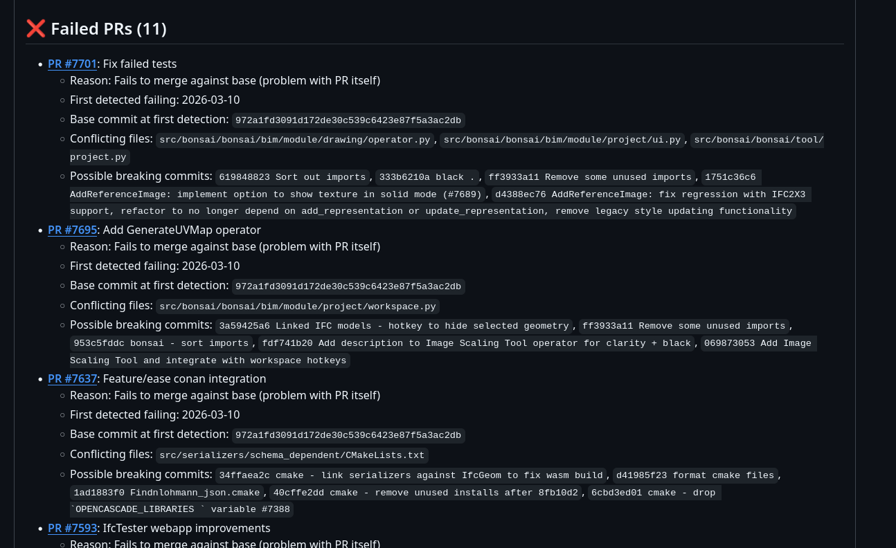

Were you able to figure out why Conflicting files: and Possible breaking commits: was missing?
Sorry I missed that. Now it is fixed. The parsing function was not following the format of the report generation.

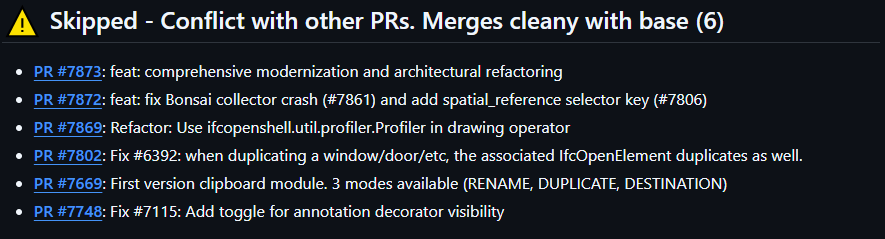

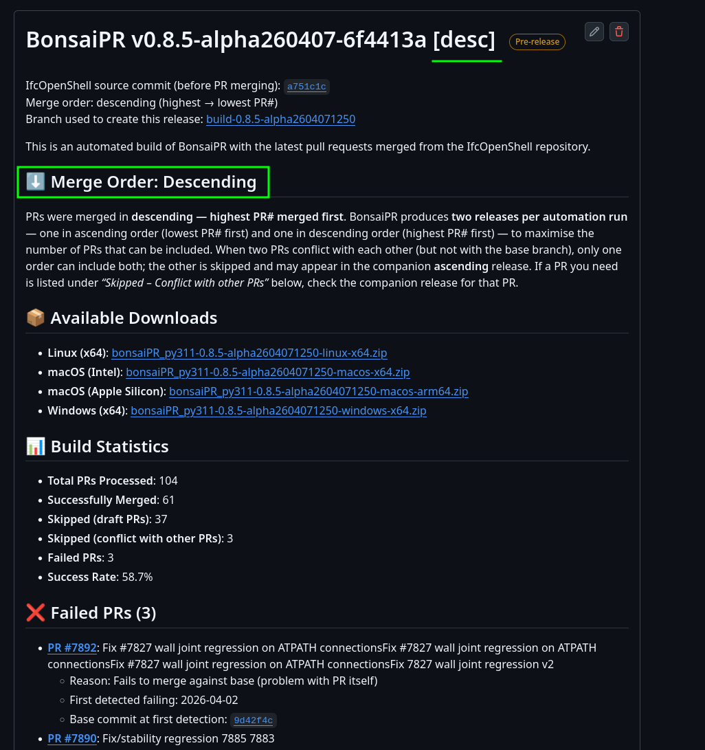

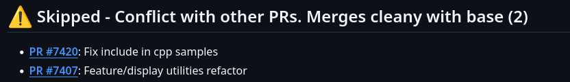

Note that the creation of releases (asc, desc, upg) is only triggered if there is any benefit:
1. Ascending [asc]: Always runs. Merges all open PRs lowest PR# first
2. Descending [desc]: Only considered if the ascending build had at least one PR skipped due to conflict with another PR (i.e. it merges cleanly against the base branch alone, but conflicts when merged together with other PRs).
3. By-Updated [upd]: Only considered if the ascending build had conflict-skipped PRs AND after the descending build there are still some PRs unresolved (i.e. still_skipped = skipped_by_asc - resolved_by_desc).
So the cases would be:

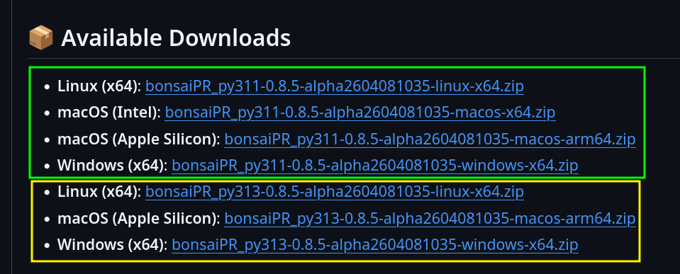

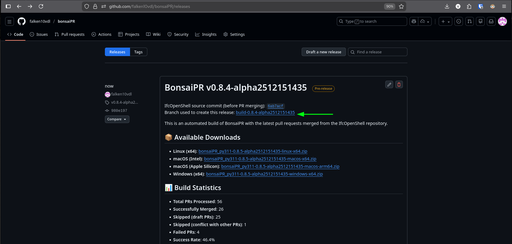

Now assets for blender 5.1 (py313) are also created. If you select automated updates the index.json file should properly find the right one based on the blender version and architecture
Sooo... which is the preferred one for people to use? [asc], [desc] or [upd]? And is that the same as in the index.json? Or does index.json just list the last release posted?
The upload script updates and commits index.json after each build that completes (each of the up to 3). So index.json always points to the last release posted in that run:
If no conflicts → index.json = ascending build
If descending helped → index.json = descending build
If by-updated also ran → index.json = by-updated build
This means the entry in index.json (currently v0.8.5-alpha2604081058) represents whichever merge strategy was the last one that produced a release — it doesn't track or distinguish between them, it just overwrites with the latest.
The releases page on GitHub would have all 3 separate releases with different timestamps (e.g., ...1058, ...1102, ...1118), but Blender users via the extension repo only ever see/install the one index.json reflects. I was just copying how the bonsai updated workflow works. I do not knwo if Blender supports choosing among options... Let me find out...
It looks that Blender's extensions do not support user-slectable variants. We could add distinct IDs (bonsaiPR_asc, bonsaiPR_desc, bonsaiPR_upd) but it would be a little bit messy and we would need then to generate all of them always or otherwise someone that had selected _upd might not receive updates for long if that one happens not to be available for a while.
What are your thoughts?

Hi @falken10vdl
Also the whole
Conflicting files:andPossible breaking commits:is missing.Another odd thing it does is, every other build seems to have additional skipped PR's even though nothing has changed...
I tired to address it here: https://github.com/falken10vdl/bonsaiPR/commit/c8660ee7be67d5fb404d60a3a2c05f589a262c6f
but was a no-go.

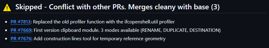

I remmber it was doing it in two passes. One oldest to newest PR numbering and the other newest to oldest. So you get two releases just in case you are more interested in the newer or in the older PRs.
Ah, gotcha! Yes i can see how that's helpful. Would it be a good idea to have some indicator on the report, as such?
@theoryshaw Actually I was looking to the list of PRs and saw that they were ordered in the report by "updated_at". I think that is also a good ordering for merging the PRs, right? So now we have each release having three possibilities: Ascending [asc] /Descending [desc] PR number and descending "updated_at" [upd].
Conflicting files:andPossible breaking commits:was missing?Sorry I missed that. Now it is fixed. The parsing function was not following the format of the report generation.

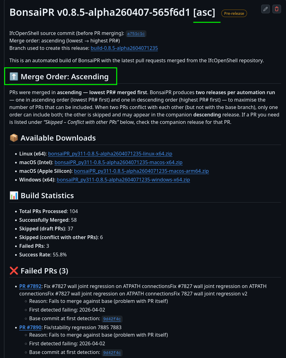

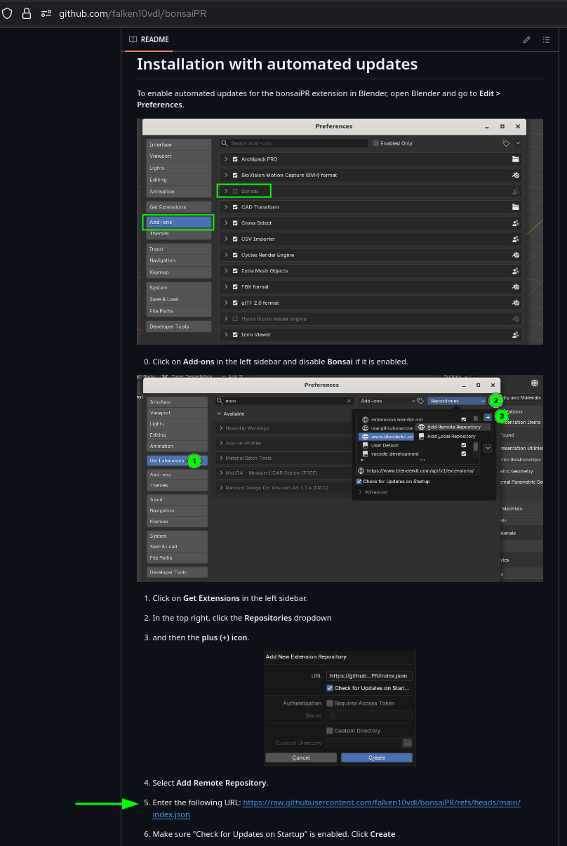

@sjb007
What index.json actually reflects:

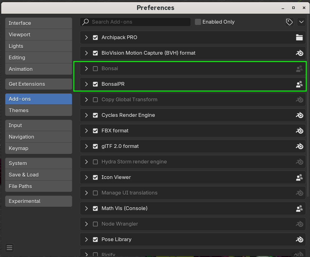

I have both bonsai unstable and bonsaiPR installed with automatic updates for both. I have also the cloned src of both with the script dev_environment_vscode_config.py run so I can set breakpoints and debug in either one.
Once I needed to download the [asc] zip file and install it since the PR I wanted to check was not available in the [desc].

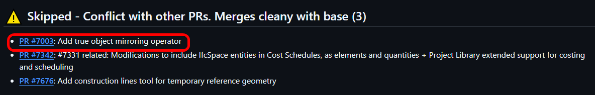

@theoryshaw Wow! You tested the prompt to get #7802 updated so it does not conflict with #7003. I am wondering how many PRs conflicts could be solved this way :)
