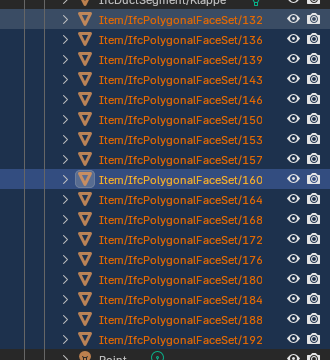

Symbols on Objects Correlating Names "Outliner" "Representation Items"
It would be cool and easier if the names are correlate or if the item is selected it would also be selected in the representation items list.

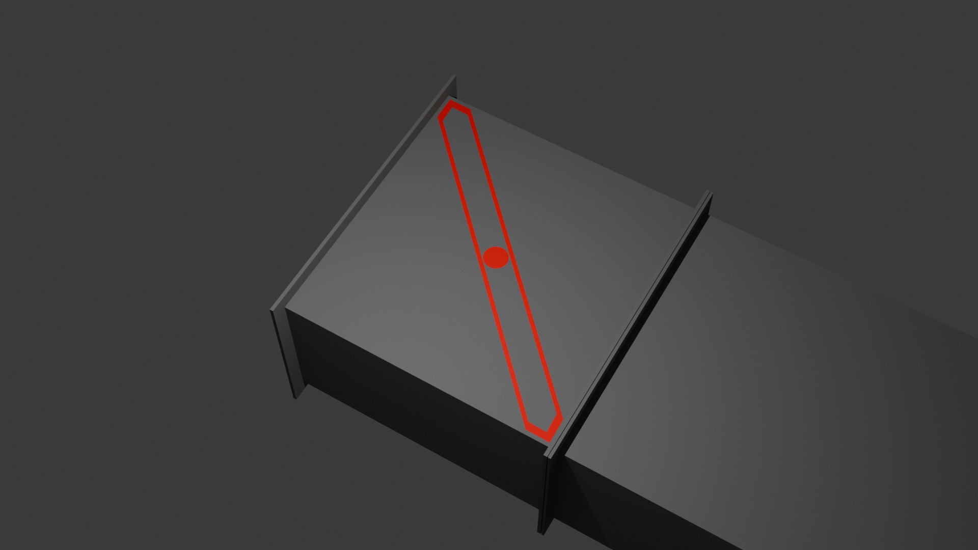

E.g. some objects imo should have symbols, take a look at this fire-flap for a duct, also with a motor (as element), imo only a red style isnt enough. Same for airvolume parts, sound-damper,...
Other ideas are welcome....

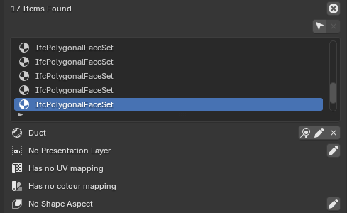

  • FYI you can name representation items by using shap aspects.
    Mas
  • MasMas
    edited October 2025
    Thx @Moult that make it easier...
    For context, if there is a fire-flap with a symbol on it, the point of the symbol is the point where inside is the plate and this point should be exact the point at a void, where the firearea is restricted...

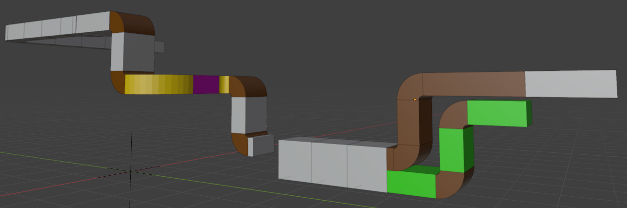

    Ran into troubles when i apply styles for duct bends (style is assigned to all objects- Type). Applying styles to straight ducts working well. (Latest unstable build 19.10.25 win py 3.11)
    If i add materials to the bends, the Style correlates with the type. (If i change the style of one bend all bends are changing).
    When adding material after applied a style to straightducts, the style is reseted, imo thats not optimal for creating ductsystems.
    ifc for testing attached
