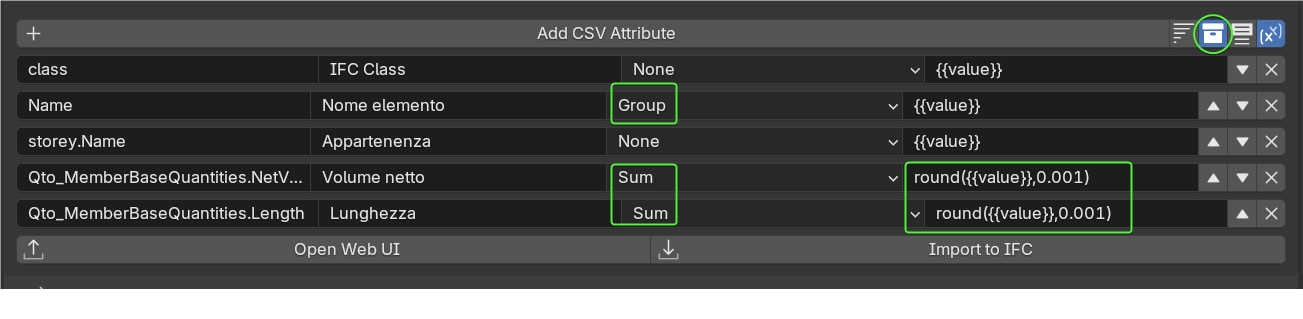

1. Is metric_length applicable to volumes as well? Is the second member of the formula the roundoff? metric_length({{value}},0.01,3)
2. Can I specify the format for the summary as well?
3. I'm not sure how to use the group function. I've created a few filters based on name, and I want to group these elements with the same name and show the total length and volume. Is that possible?

@mastrolube said
you can use round({{value}},0.001) for three decimal places if you don't need to round it up
all numeric attributes can be formatted accordingly
see if this can help:

@mastrolube
you may also want to explore REGEX for your selector
in your "Attribute" field your filter would look like:
Name=/.*@B-PAKET@.*|^Schwelle$|^Pfosten$/to catch all names with
@B-PAKET@inside, along withSchwelleandPfostencheers
