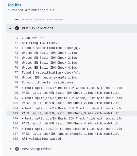

To configure IDS testing, create a .github/workflows/ids-lint.yml file with this content and add it to your repo:
Show ids-lint.yml
name: IDS Compliance Check
on:
  push:
  pull_request:
  workflow_dispatch:
jobs:
  ids-lint:
    runs-on: ubuntu-latest
    steps:
      - name: Checkout repository
        uses: actions/checkout@v3
      - name: Set up Python
        uses: actions/setup-python@v4
        with:
          python-version: '3.10'
      - name: Install ifctester and idssplit
        run: |
          pip install ifctester
          pip install --no-deps https://github.com/brunopostle/idssplit/releases/download/0.1.0/idssplit-0.1.0-py3-none-any.whl
      - name: Run IDS validations
        run: |
          set -e
          shopt -s globstar nullglob
          if [ ! -d IDS ]; then
            echo "No IDS/ folder found"
            exit 0
          fi
          ids_sources=(IDS/**/*.ids)
          if [ ${#ids_sources[@]} -eq 0 ]; then
            echo "No IDS files found in IDS/ folder"
            exit 0
          fi
          ifc_files=(**/*.ifc)
          if [ ${#ifc_files[@]} -eq 0 ]; then
            echo "No IFC files found"
            exit 0
          fi
          mkdir -p split_ids
          echo "Splitting IDS files..."
          for ids in "${ids_sources[@]}"; do
            idssplit "$ids" split_ids/
          done
          split_ids_files=(split_ids/*.ids)
          if [ ${#split_ids_files[@]} -eq 0 ]; then
            echo "No rules found after splitting IDS files"
            exit 1
          fi
          echo "Running ifctester validations..."
          failed=0
          for rule_ids in "${split_ids_files[@]}"; do
            for ifc in "${ifc_files[@]}"; do
              echo "::group::Test: $rule_ids with $ifc"
              echo "Testing: $rule_ids with $ifc"
              output=$(python3 -m ifctester --no-color "$rule_ids" "$ifc" || true)
              echo "$output"
              echo "::endgroup::"
              if echo "$output" | grep -q '\[FAIL\]'; then
                echo "FAIL: $rule_ids with $ifc"
                failed=1
              else
                echo "PASS: $rule_ids with $ifc"
              fi
            done
          done
          if [ "$failed" -ne 0 ]; then
            echo "One or more validations failed"
            exit 1
          else
            echo "All validations passed"
          fi
You also need to create an IDS/ folder in your repository for any .ids files you want to use, these will be picked-up automatically.

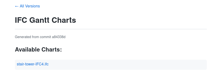

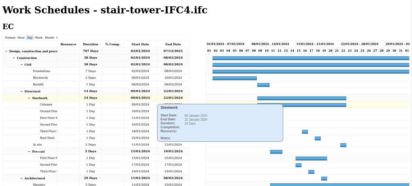

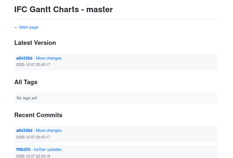

  • Here's another git forge workflow: automatic generation of Gantt charts for any IFC Schedules in the repo and putting them online (on githib pages for example).
    For each commit and tag in the default branch an entry is added to an index page at /ifc4d/ on the site:
    ..then a page is generated for the commit/tag showing the available IFC files in the project:
    ..where each Schedule is shown as a Gantt chart:
    Code is here, basically this is the Bonsai Gantt functionality extracted as a standalone tool: https://github.com/brunopostle/ifc4d-gantt Instructions for setting up the workflow are in the GITHUB_ACTION_USAGE.md file.
