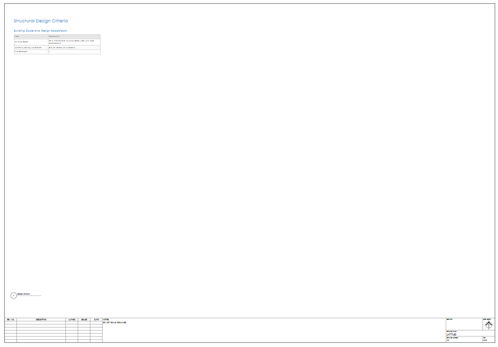

Using the attached file, if the SVG to PDF Command is empty, it prints out the following as a svg...
But if you do something like
SVG to PDF Command = [["inkscape.exe", "svg", "-o", "pdf", "--export-dpi=300"]]
... it doesn't show the referenced svg

Basically trying to find a workflow pipeline to print out a styled .markdown text to a printed PDF from Bonsai. A pdf, where the resultant text is searchable and selectable.
I vibe coded this bat script that converts a .md to an svg. The only way, i could find to make the resultant text searchable/selectable, in the resultant svg, is to put it in a
<foreignobject>.Currently, if you open the sheet svg in chrome, for example, and print to a pdf, the svg shows up, but when i try to do it headless via Bonsai, it doesn't work... probably missing something obvious.
