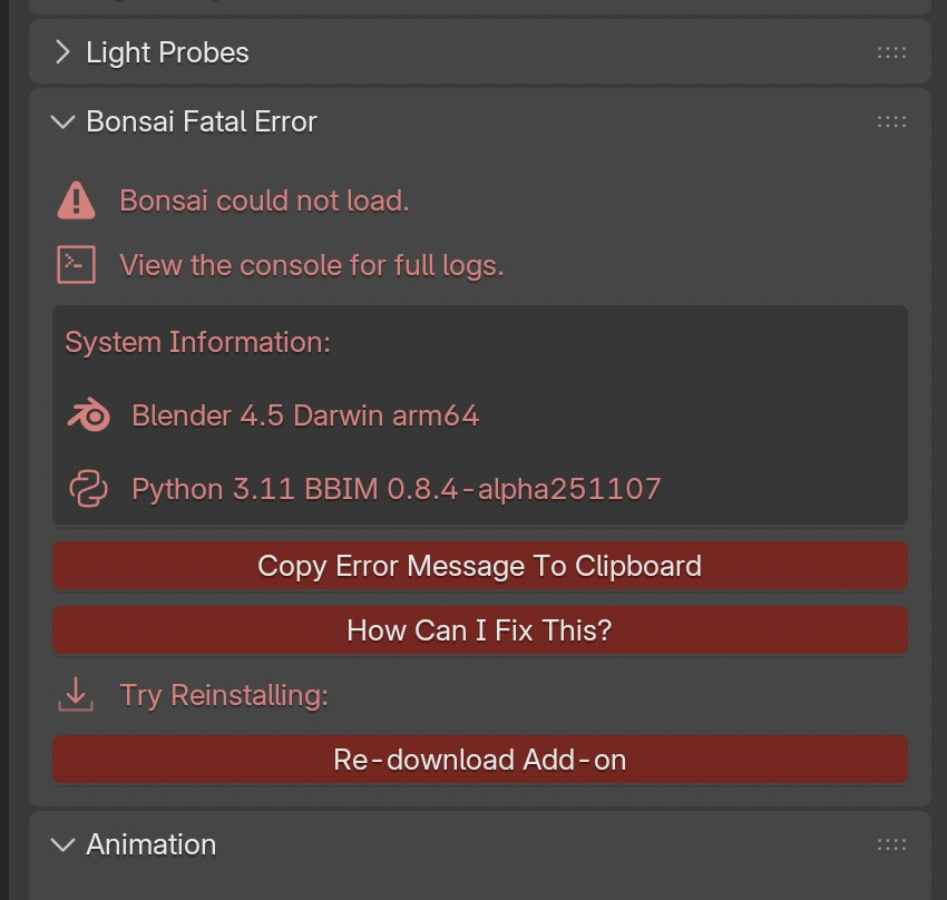

For a while I have seen that Bonsai dailies do no more work on Blender 5.0 Beta and 5.1 Alpha. Not a big issue as it worked with 4.5.4 LTS.
So, as 5.0 in Beta for a while and 5.0 release soon, I was very pleased that about a week ago Bonsai installed and work fine on 5.0 and even 5.1 again. This worked fine and also updated for quite a few days.

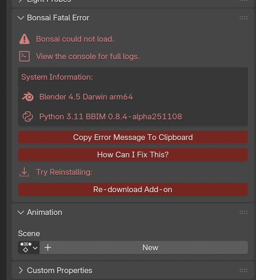

Since a few days that broke again for 5.0 Beta and 5.1. Unfortunately that also broke Bonsai for 4.5 official ! And it might correlate with Apple's release of macOS Tahoe 26.1 Update (!?)
As it looks like I am the only active Bonsai on Mac tester, or at least on this Forum, I thought that incompatibility might went under the radar, so I it might be ok to mention.
