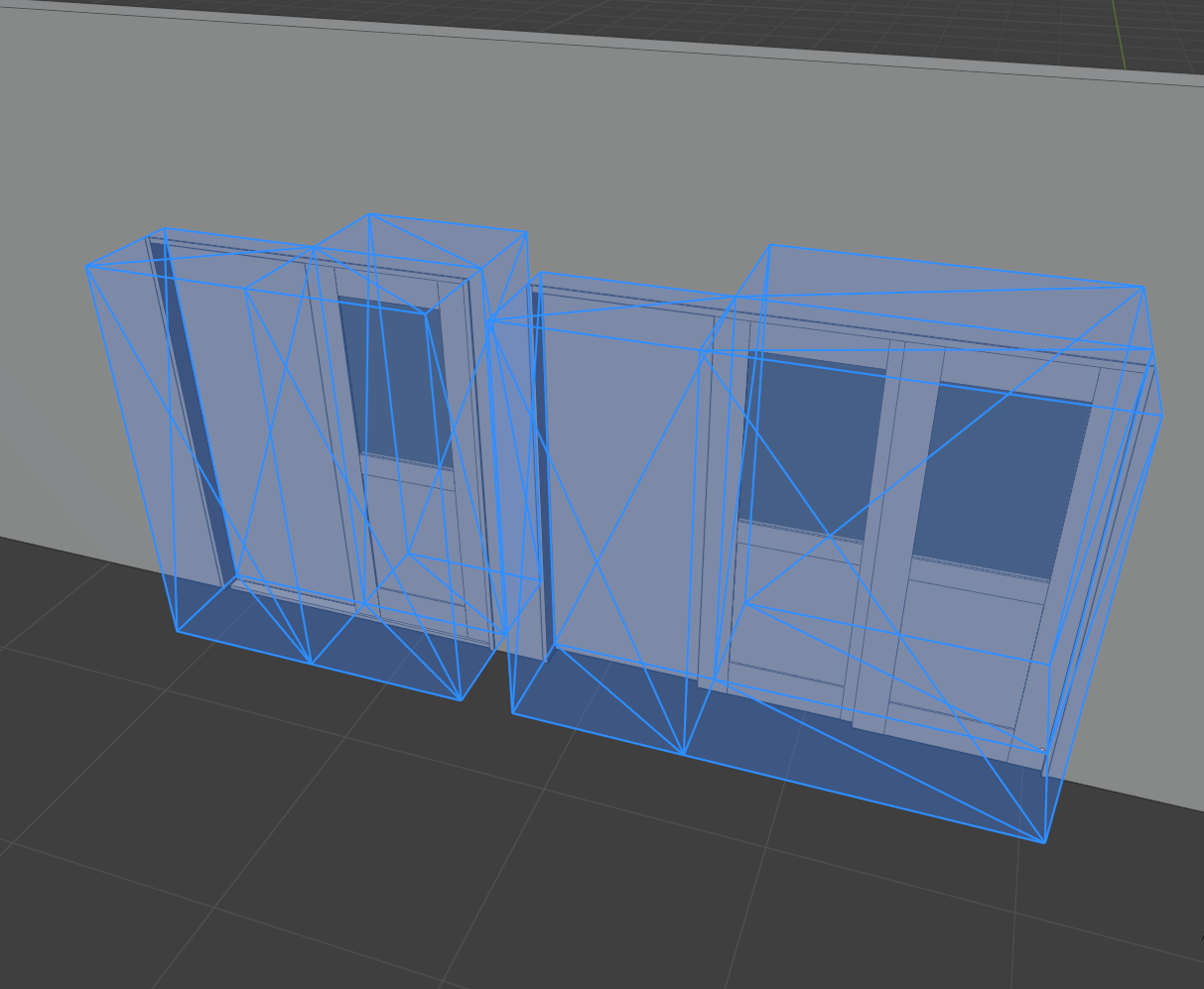

I am currently creating a library of IfcDoorTypes and etc.

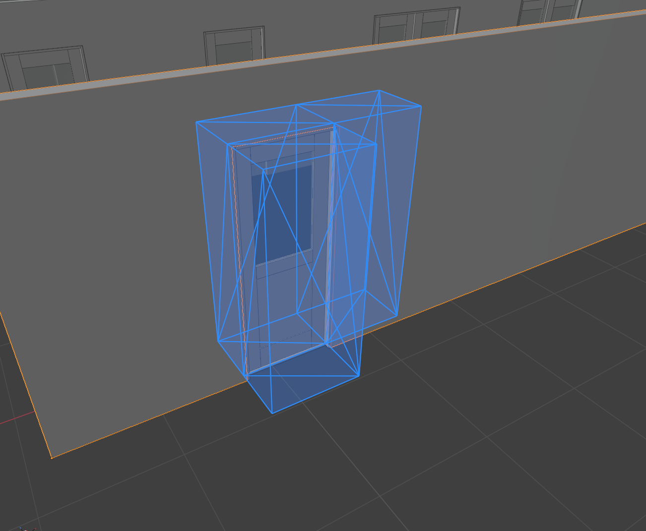

However, when I import IfcDoorType from my library, the opening corresponding to a door type does not work.
Does anyone know how to set it right?
I believe the void is not defined in IfcDoorType, so this causes a problem.

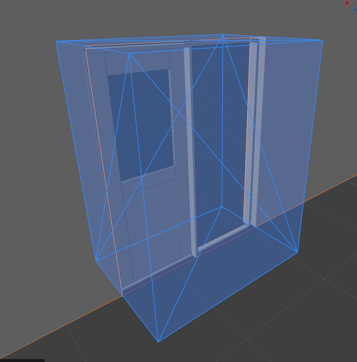

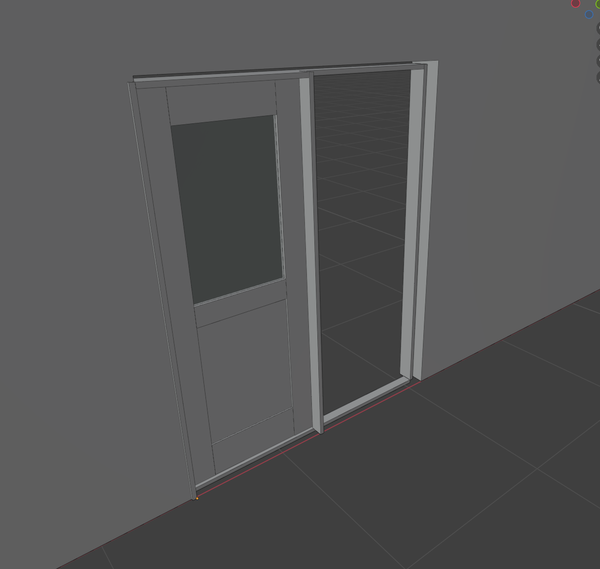

The opening should look like this:
(I modified it at an instance level)
@yoayo
Yes the edited void of custom doors works fine inside the file when duplicated but sort of resets when imported.
