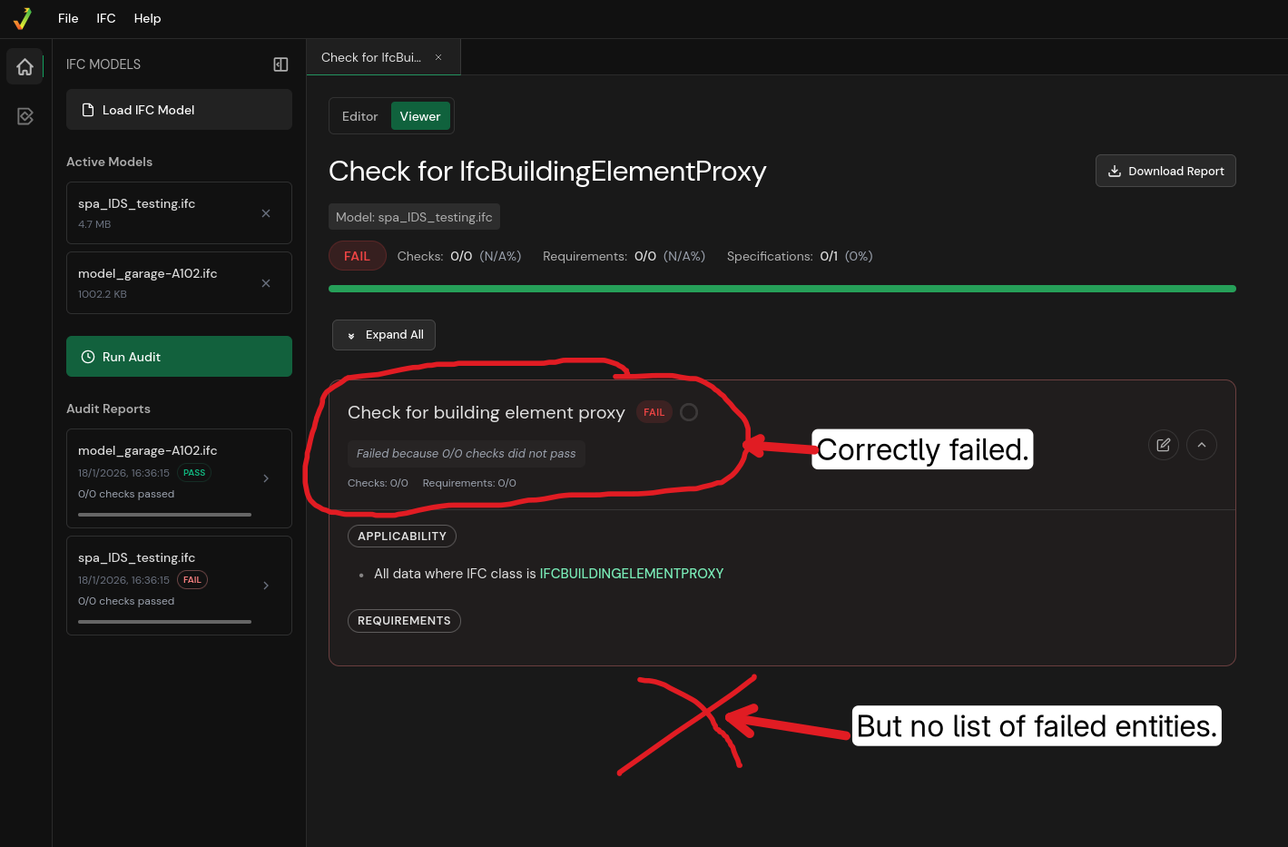

I am trying to create IDS that would check for all IfcBuildingElementProxy entities in a project and the rule should fail if there is any.
After some testing with IFC Tester, I ended up with this IDS structure:
IfcBuildingElementProxy with GlobalId attribute is prohibited

This works well, but the GlobalId check could be omitted.
But when I setup the IDS like this:
IfcBuildingElementProxy is prohibited

IFC Tester gives me the good pass/fail results, but it does not list the failed entities, which I would like to have as an output:
Is there a way to list failed entities (basically all IfcBuildingElementProcies) in the result without having to have a 'dummy' requirement for GlobalId?

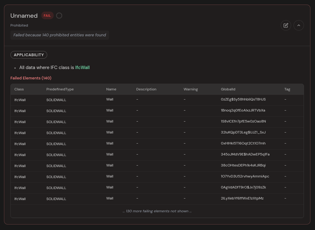

Massimo
  • Perhaps my understanding of IFC is lacking.
    I interpret that the topmost inheritance level for the Attributes of IfcBuildingElementProxy is IfcRoot, and that the #1 GlobalId is not optional but a mandatory assignment 😵‍💫
    semhustej
  • edited January 19
    I think that is correct. So the first IDS is bulletproof and dos the job correctly. But I am still wondering if there is a way to setup the IDS just to check IfcBuildingElementProxy existence without any additional conditions.
    KoAra
  • You are correct about the first IDS. The audits are correct, just the report doesn't make it clear or show the complete results. Now fixed.
