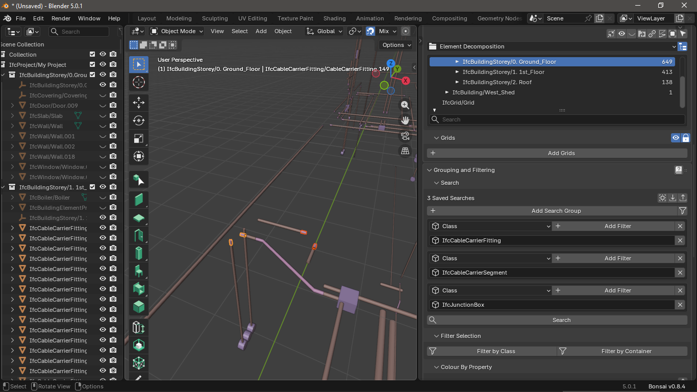

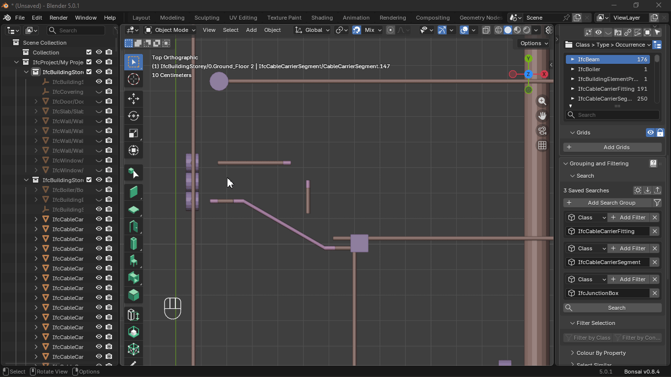

So I had this issue with previous Bonsai/BlenderBIM versions, but at least it was rengering accurately. Since I upgraded to Blender 5.0.1 and Bonsai v0.8.4 the IfcCableCarrierFitting bends no longer render properly. So maybe someone has an idea how to fix this. Because otherwise, will have to manually remodel each of the bends (Again I think...)...
Whenever I would create such fitting :
{"start_length": 30.000001192092896, "end_length": 30.000001192092896, "radius": 60.00000238418579, "angle": 89.99999066533266, "lateral_axis": 0, "lateral_sign": 1, "z_axis_sign": -1, "main_profile_dimension": 8.0}
in previous Bonsai version the UI would throw a bunch of errors, but eventually would render the IfcCableCarrierFitting

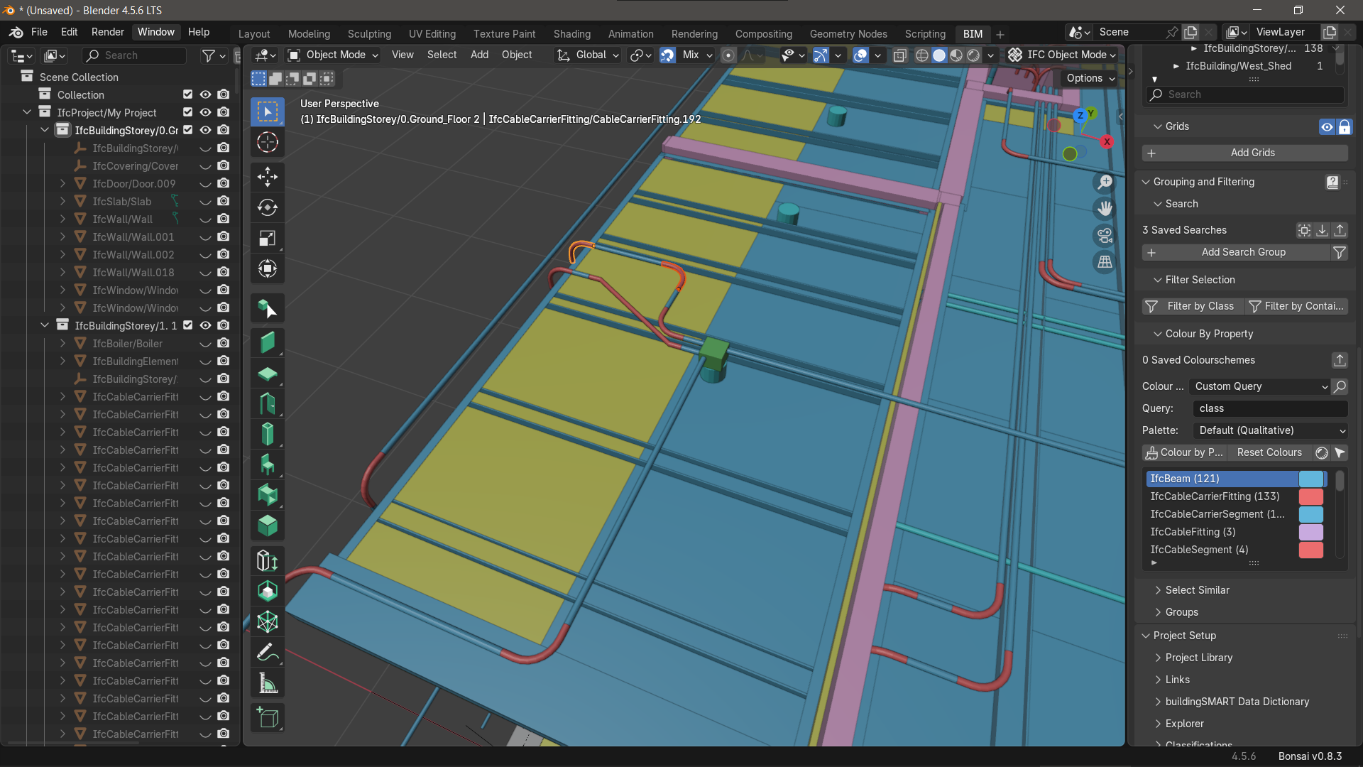

  • And below the IfcCableCarrierFitting hacking in action:
    KoArasteverugiwalpa
  • So I found a way around this conduit/pipe bends/elbows not rendering properly issue by Installing Blender 4.5.6 and Bonsai v0.8.3 and the IfcCableCarrierFitting bends are back. Yeah Baby!
