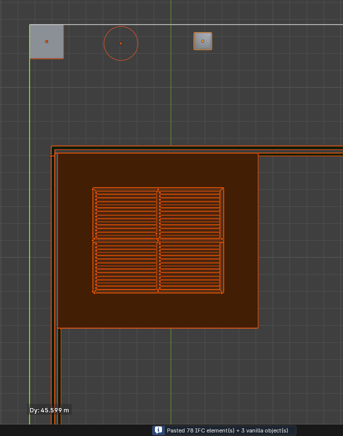

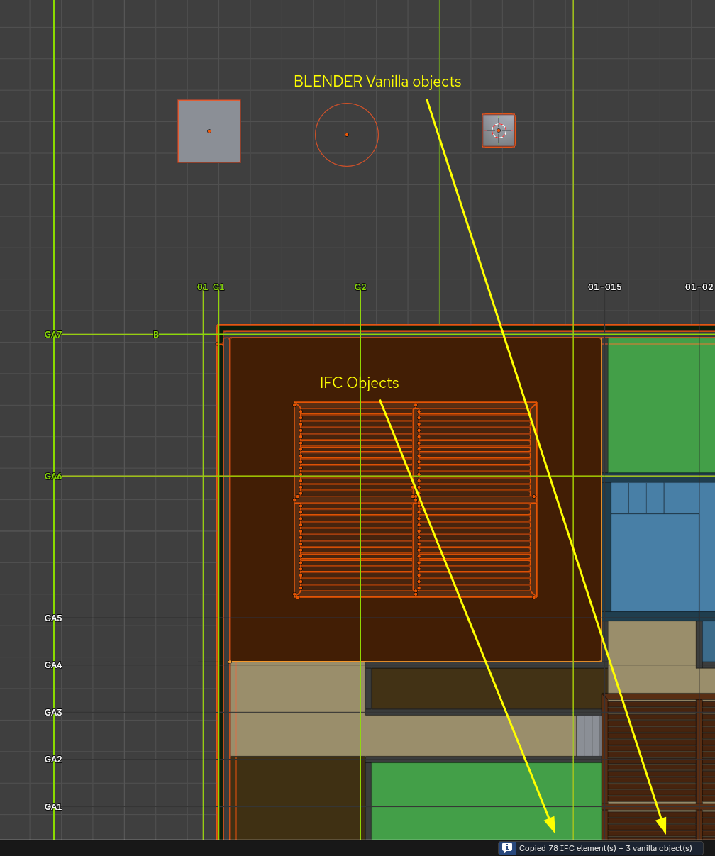

Added to PR! Now selection is split in two sets: Vanilla Blender objects and IFC objects. Vanilla Blender objects are copied using the blender clipboard buffer and IFC objects are copied using the Bonsai clipboard buffer.
Thanks!
It is possible to copy and paste multiple objects. Example:
