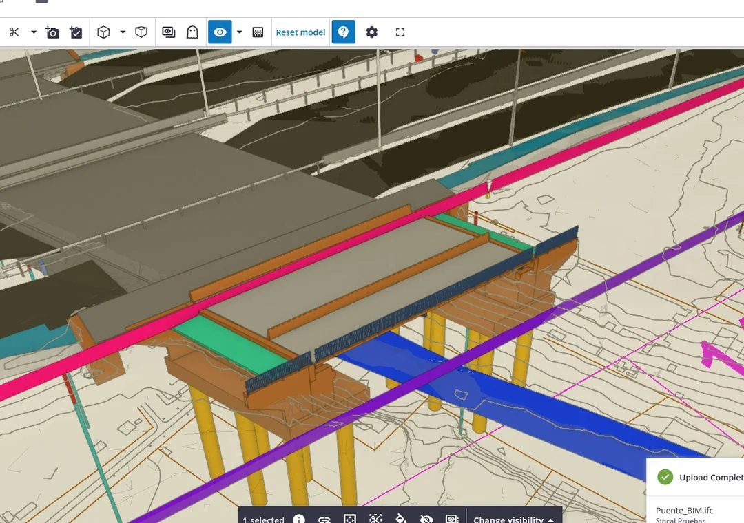

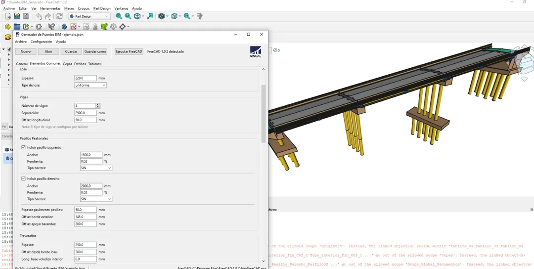

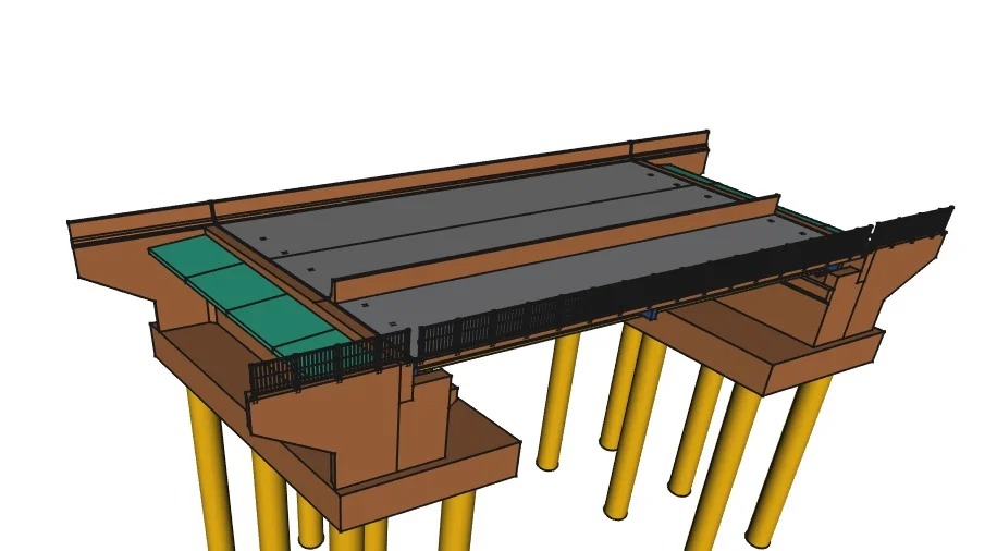

This is a really interesting use case of FreeCAD:
  • A macro that creates a parametric bridge
  • Export the bridge model from FreeCAD as IFC file. FreeCAD offers basic georeferencing.
  • Import to Trimble Connect CDE for coordination
Note that I am not the author, I am just spreading the word. The original post by the author is from Reddit: https://www.reddit.com/r/FreeCAD/comments/1r2dffy
