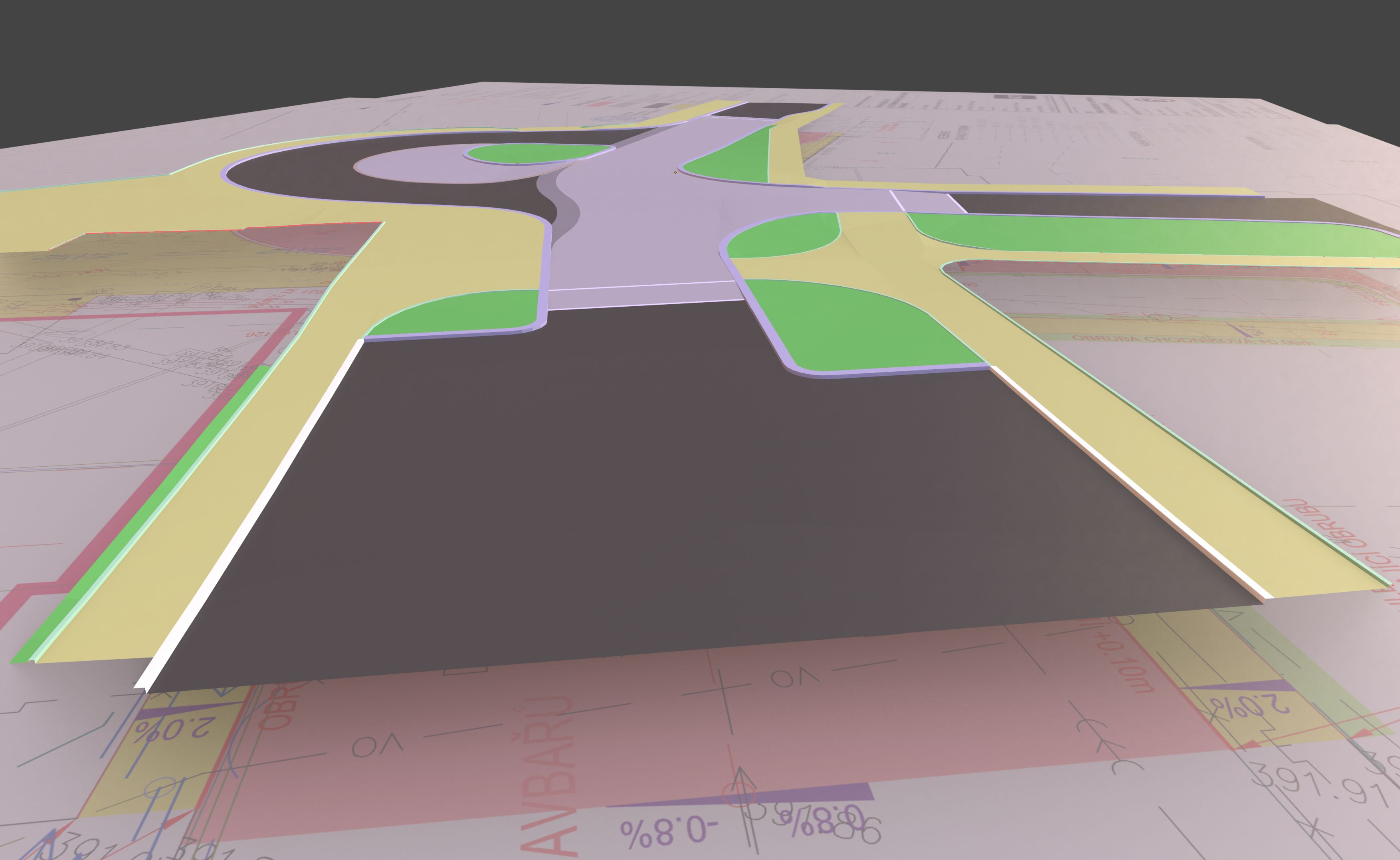

2. Rebuild project geometry in 3D
Most infrastructure projects still arrive mainly as 2D drawings.
When converting them into real 3D geometry you often discover issues immediately:
  • incorrect elevations
  • inconsistent slopes
  • geometry conflicts
  • drainage problems
By rebuilding the geometry as real surfaces in Blender (roads, sidewalks, terrain transitions), I can often detect problems before construction starts.
3. Terrain modelling and slope verification
A large part of road design is about correct slopes and drainage.
Inside Blender I often model surfaces and visually verify things like:
  • road cross slopes
  • transitions between surfaces
  • terrain shaping
Sometimes I even run simple rain simulations to visually check where water flows.
This can reveal problems that are not obvious in 2D documentation.

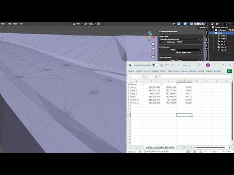

4. Generating staking points
Once the geometry is correct, I generate staking points directly from the model.
Instead of manually measuring elevations on site using a level and reading them from cross-sections, I can export the exact coordinates of important points directly from the model.
These can then be sent to the surveyor or used for machine control preparation.

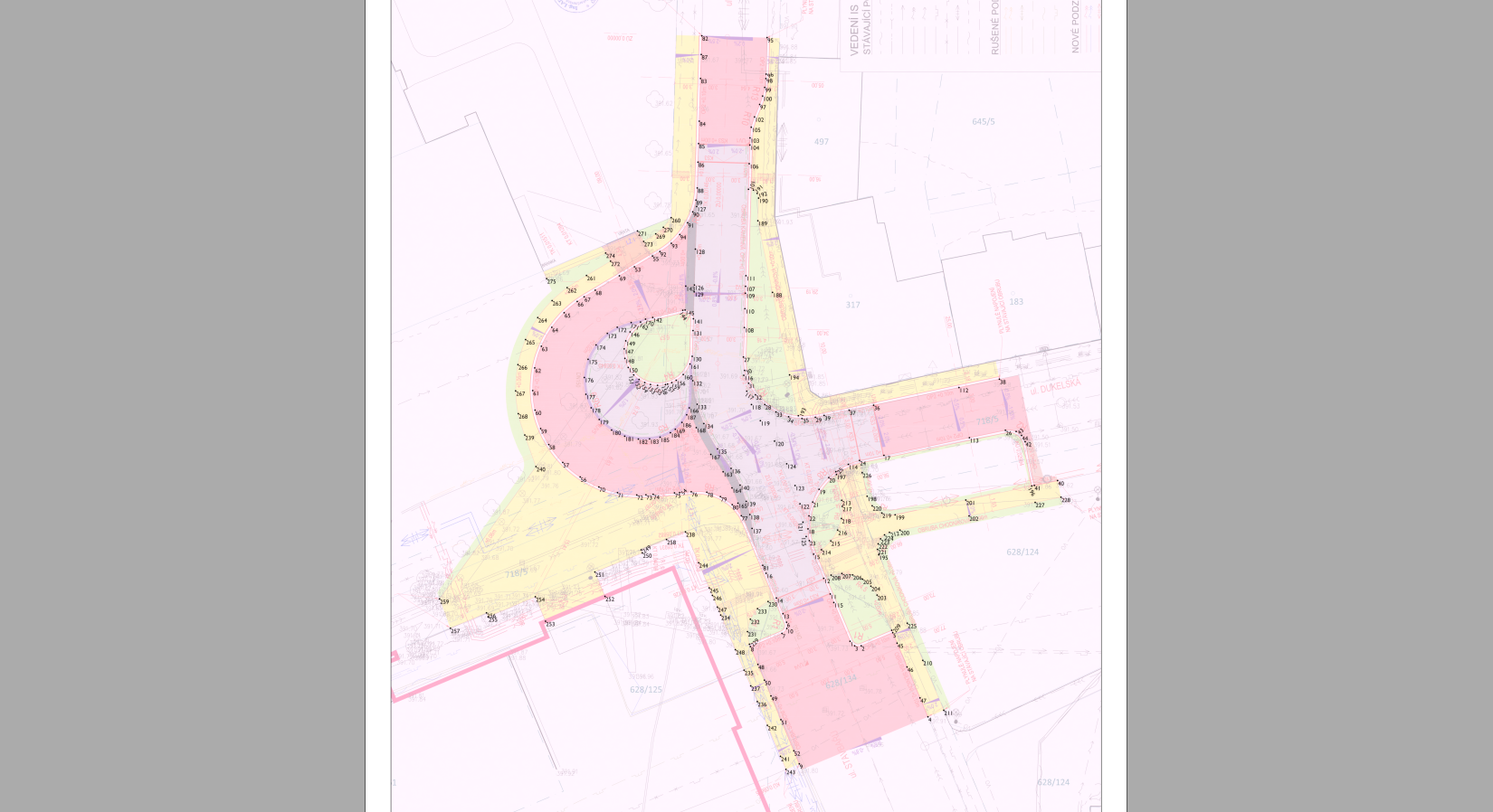

5. Producing point diagrams and drawings
On construction sites it's still very common to work with simple printed drawings showing labelled points and elevations.
For example:
  • staking points
  • curb elevations
  • slope breaklines
  • drainage points
Clear diagrams with labelled coordinates are extremely useful for communicating geometry on site.

Survey Points Exporter
Exports selected points back to TXT/CSV so they can be used by surveyors or machine control systems.

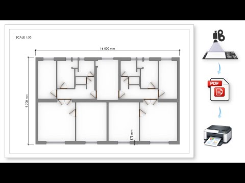

Scale Print Camera
Creates true-scale technical drawings directly from Blender.
You can define:
  • paper size
  • drawing scale
  • DPI
and export renders that print at exact scale in PDF.

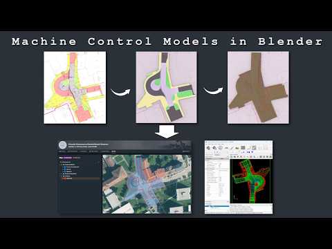

Most of these tools started as small scripts I wrote for my own construction projects, and they gradually evolved into more structured add-ons.
I'm currently finishing a full timelapse of the entire workflow, showing how a construction model for machine control (UniControl) is created in Blender.
It should be ready in a few days — if people are interested I can share it here.

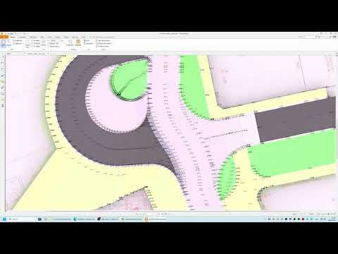

  • Thanks for the interest — here is the timelapse video of the full workflow:
    It shows the complete process in Blender, from importing survey/stakeout points and drawing references, through terrain and road surface modelling, slope/drainage checking, up to generating outputs for construction use.
