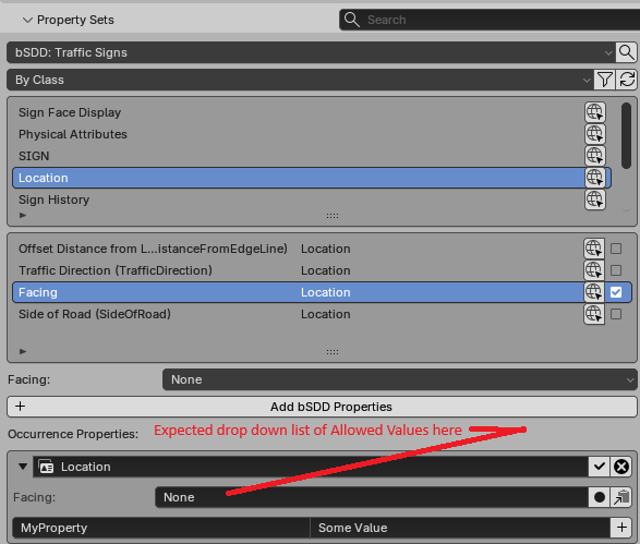

I have an IFC model of a sign, that is classified with class in the bSDD. Some of the properties define allowed values. I was expecting the UI to provide a drop-down list of the allowed values from which to select. This didn't happen.
Is this not a thing?
Is this not a feature of Bonsai?
Is my bSDD incorrect?
Here is an example property from the bsdd. https://search.bsdd.buildingsmart.org/uri/wsdot/wsdotsigns/0.5/prop/Facing
