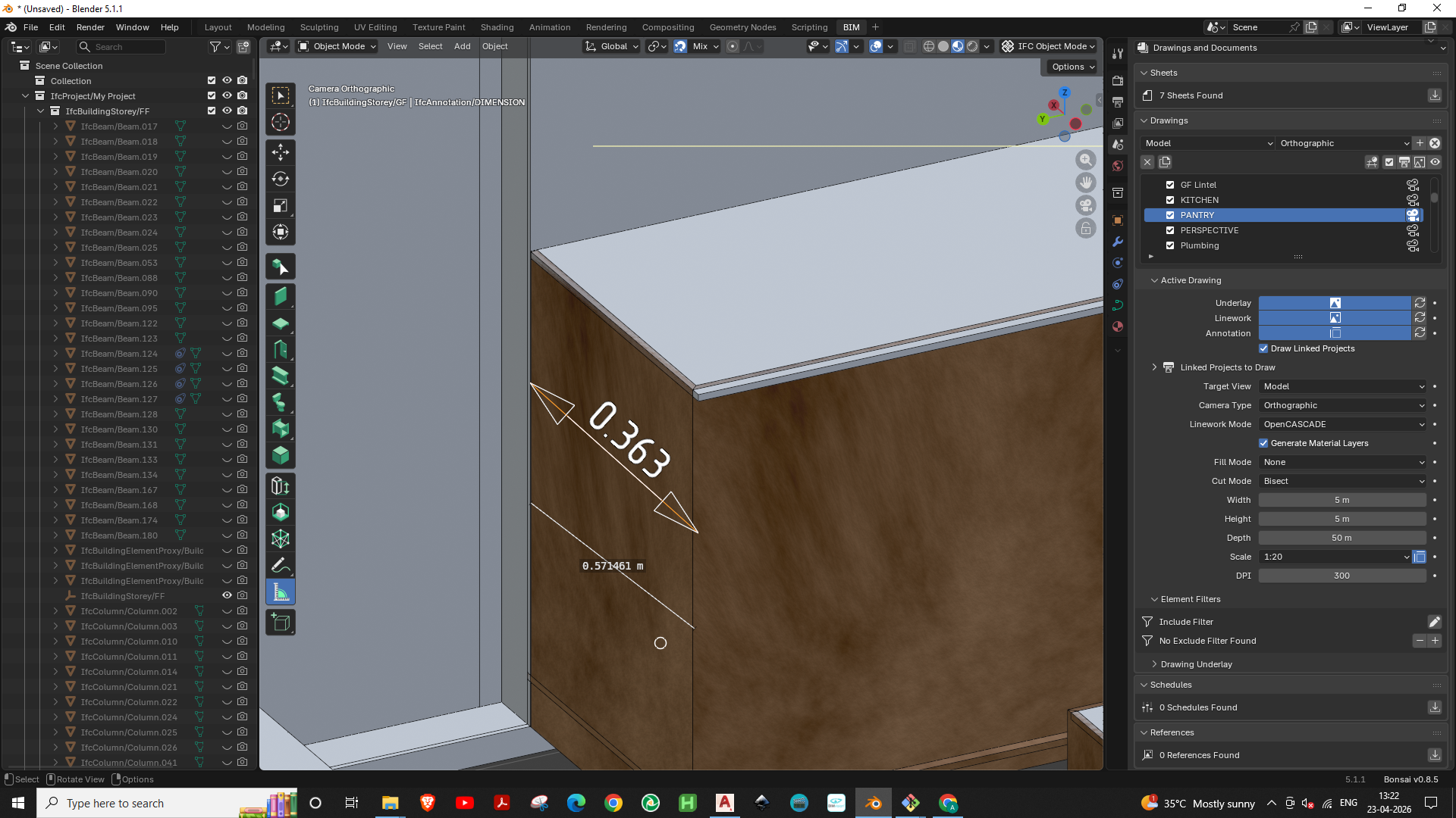

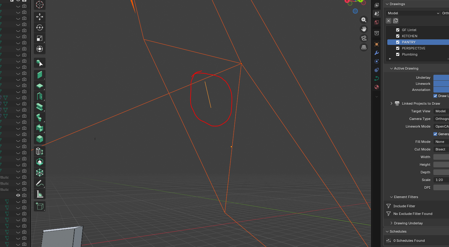

How to correctly put the dimension in the Orthographic view. When I snap the dimension end points to the object also, its showing wrong dimension.
The dimension line is actually projected in the orthographic view, how to solve this? Experts please advice :)

    yeah, i think this would be a good feature request, as currently i think bonsai automatically 'flattens' dimensions on the camera's view plane, but i think there should be an exception for axonometric drawings.
    Added the feature request #8006 :)
