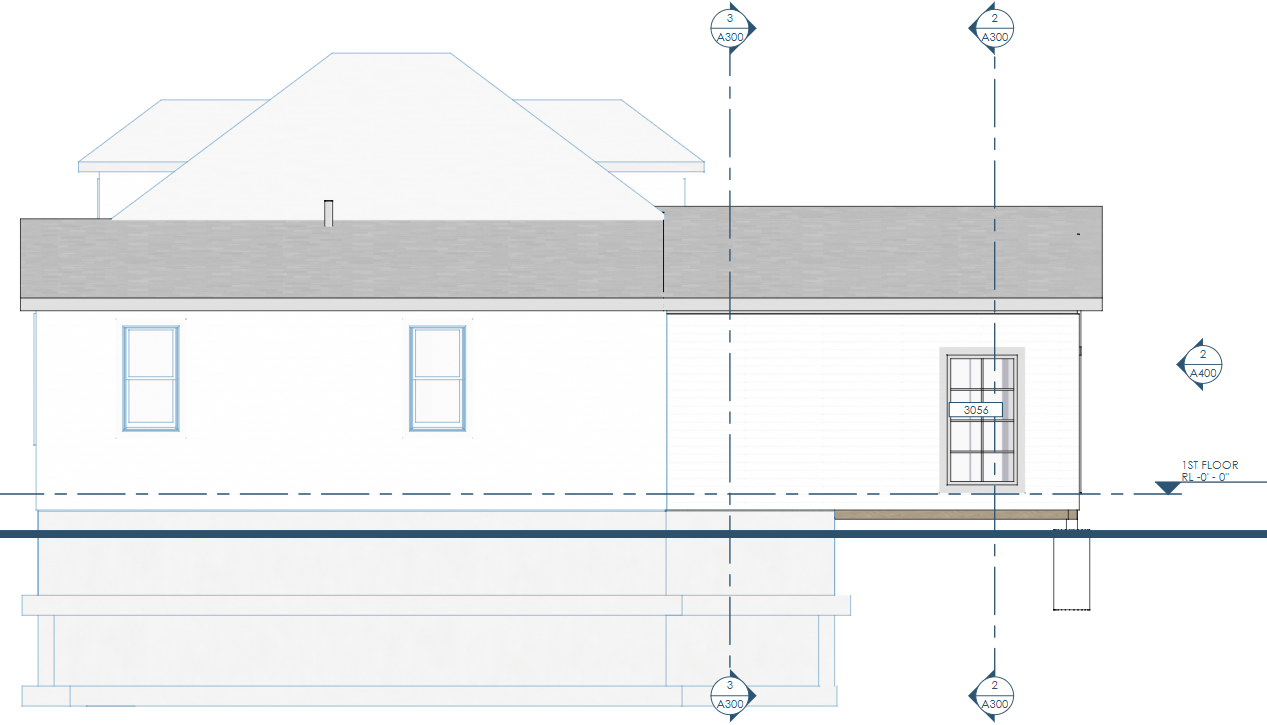

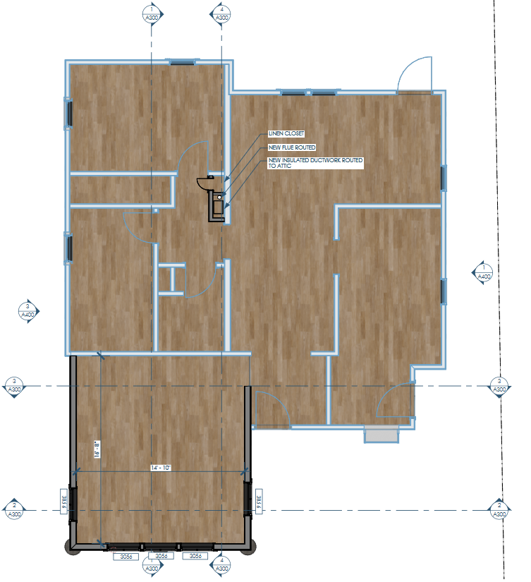

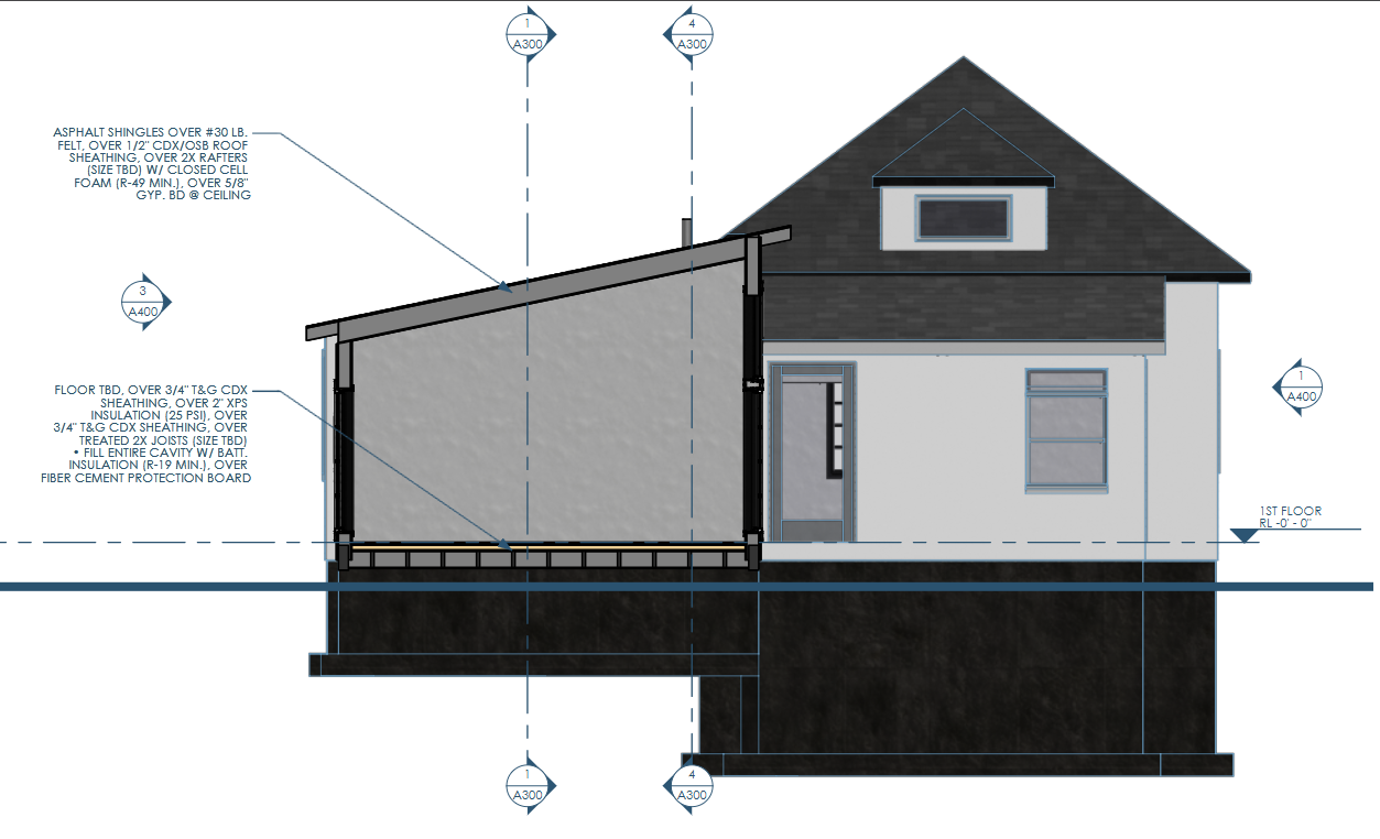

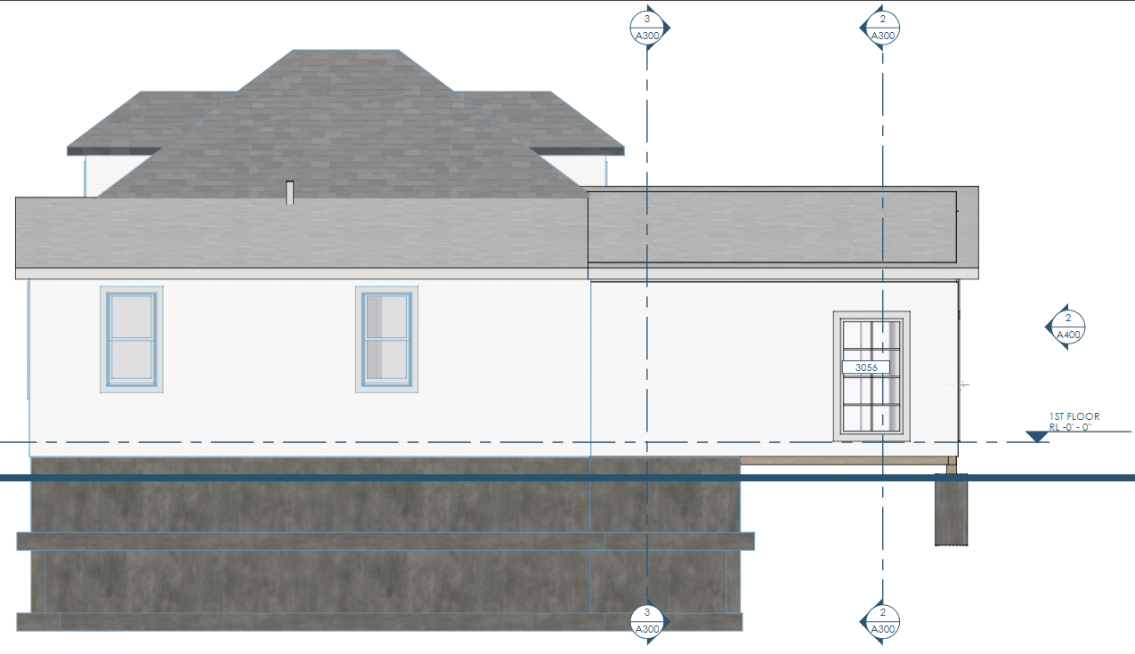

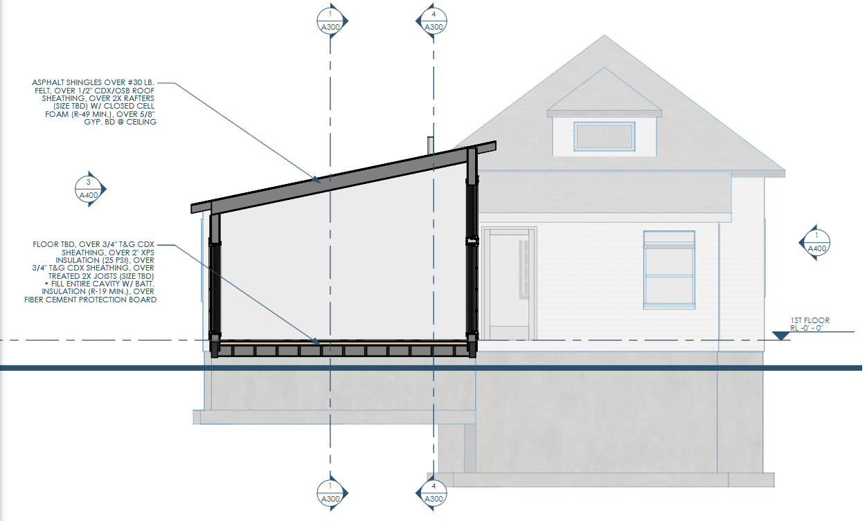

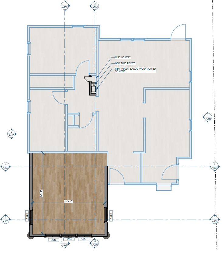

    a couple examples of 'graying out' existing conditions...
