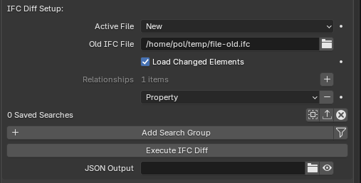

I am trying to run IfcDiff in Bonsai. When I am trying to include comparison of properties, I am getting errors.
I am attaching my sample old and new file. I am able to reproduce with various files.
This is my IfcDiff settings:
When running it, I get this error:
