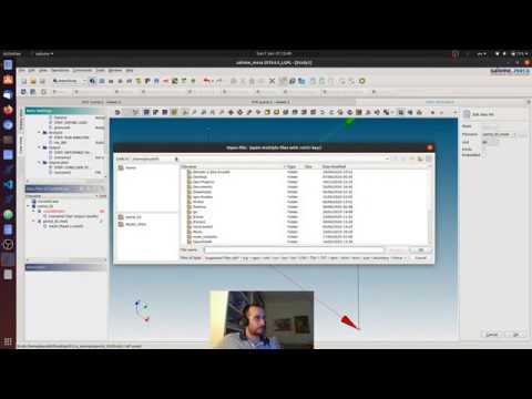

ifc2ca short presentation
Given that today the time went by very quickly with all the interesting questions that were raised I did not have the opportunity to show anything about IFC2CA, I made this video to show how to create all the scripts and run a simple portal example that is the official file from buildingSmart. If there are any questions or anyone wants to know more let me know, I will be glad to answer
