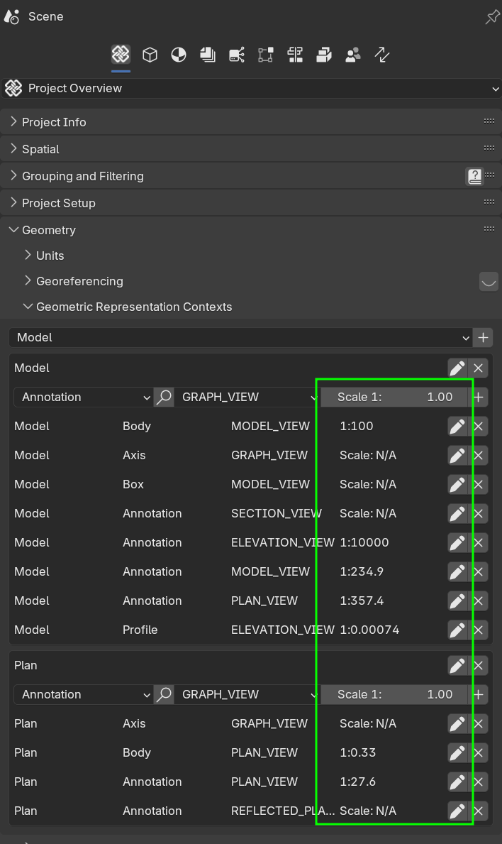

Here a proposal to add TargetScale to Geometric Representation Context (TargetScale attribute in IfcGeometricRepresentationSubContext).
I have opted to add in the UI the denominator of the scale because the decimals where giving "funny artifacts" . i.e you add 100.0 for a scale of 1:100. The denominator is still a float so you can add scales like 1:0.23 or 1:0.86. It is all transformed to TargetScale = 1 / DenominatorScale when writting to ifc
Here the PR: TargetScale support Subcontext #6816
