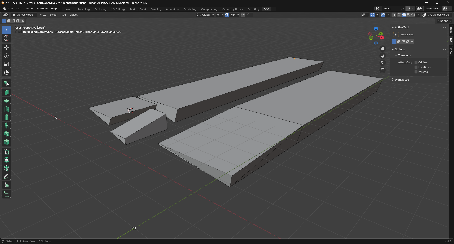

  • QTO IfcGeographic Element Not qualified
    bpy.ops.bim.perform_quantity_take_off()
    Quantities are calculated for 1 elements. 1 of them were not quantified, see system console for the details.

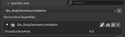

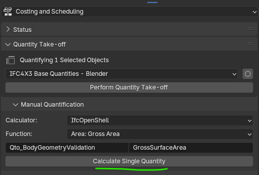

  • @sahrul
    you can do it with Costing and Scheduling > Quantity Tare-off > Manual Quantification
    here the example to calculate area
