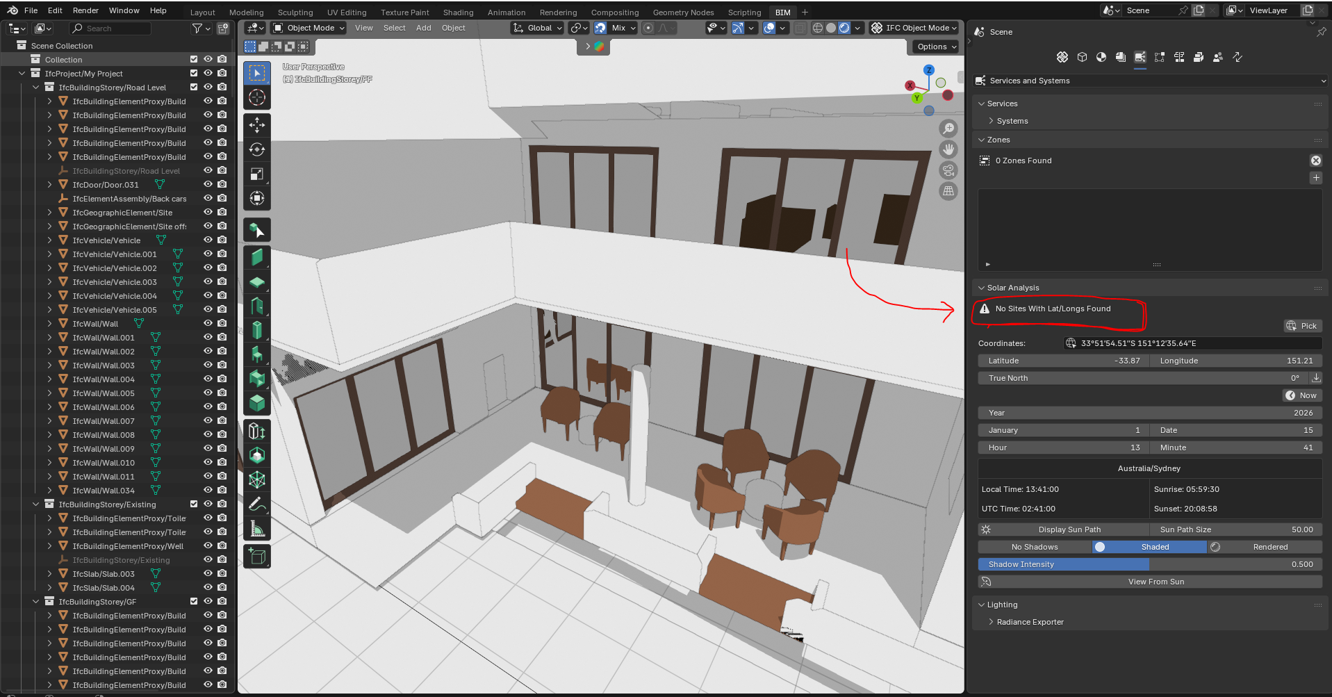

No Site With Lat/ Longs found. How to add Lat/ Longs?
In the Solar Analysis how to permanently add the cordinates in the Site?

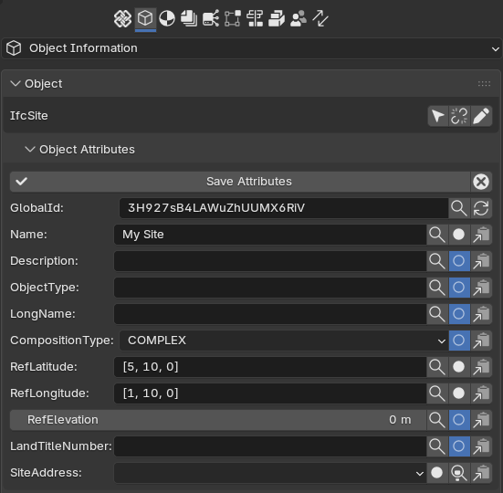

did you try to edit long lat in IfcSite attributes?
the format is in square brackets [deg,min,sec]

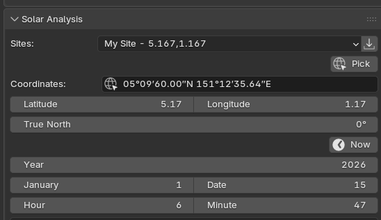

to make them available in solar analysis click the "arrow-down" icon to the right of the site coordinates
Please see https://community.osarch.org/discussion/2954/help-adding-latitud-and-longitud-to-ifcsite/ about syntax including sign.

Yeah it worked, initially I tried entering in this format 10.1632° N, 76.6413° E, which gave error.
