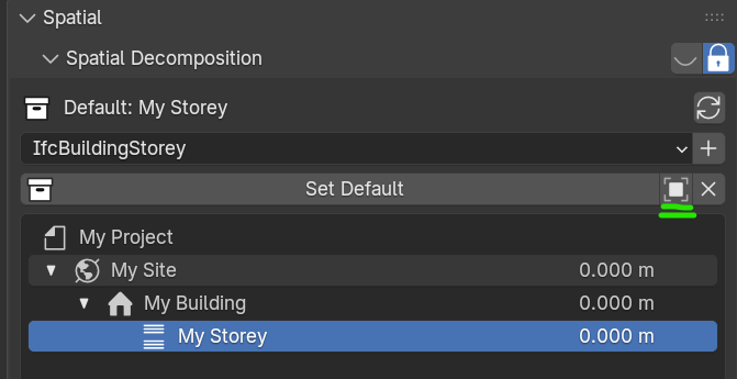

    To edit go to Spatial Decomposition, click the 'square' icon to select it

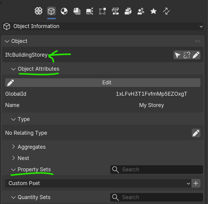

    now go to Object Information where you can see Object Attributes and down below it Property Sets
    happy editing
