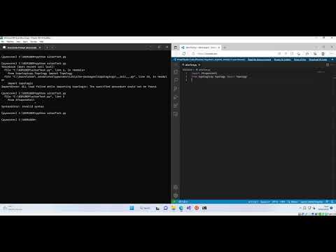

Thank @topologic , please see the screen recording reproducing a strange behavior that "sometimes" makes importing fail
I'm working on a clean windows 11 installation on a VM, just with one python 3.9.16 running inside the conda enviroment. Topologicpy is 0.025 and ifcopenshell is 0.7.0
As I suspected. Ifcopenshell is probably using a different version of occt than topologicpy and thus it is conflicting.
