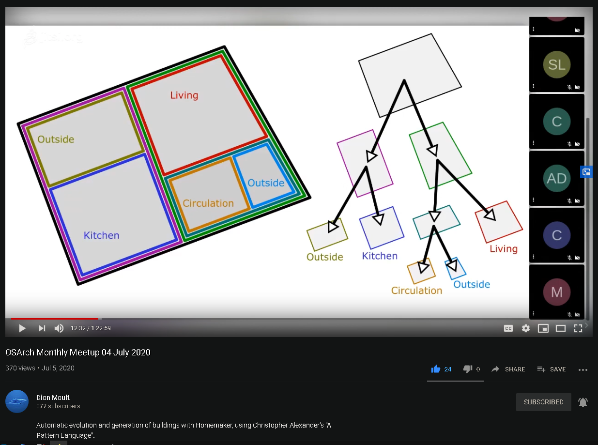

I see a potential in evolutionary algorithms for now though, if anyone is also interested in this, sverchok should have a working GA node:
https://github.com/nortikin/sverchok/pull/3284
Clearly buildings can be designed with an evolutionary approach, though my suspicion is that it only really works with building forms that are 'adaptive' in the first place. i.e evolving traditional architecture is possible, but modern architecture I'm not so sure, how would the computer know if the result was any good?
I don't see AI and machine learning (as distinct from genetic algorithms) designing buildings any time soon.
[Edit] I think AI will be very good at writing marketing texts for architects.

Sverchok has genetic Algorythm node if something
