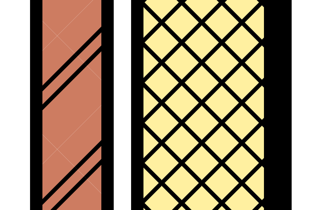

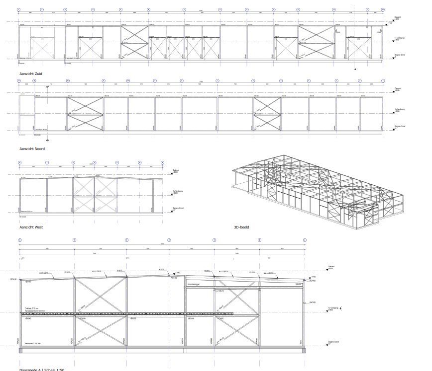

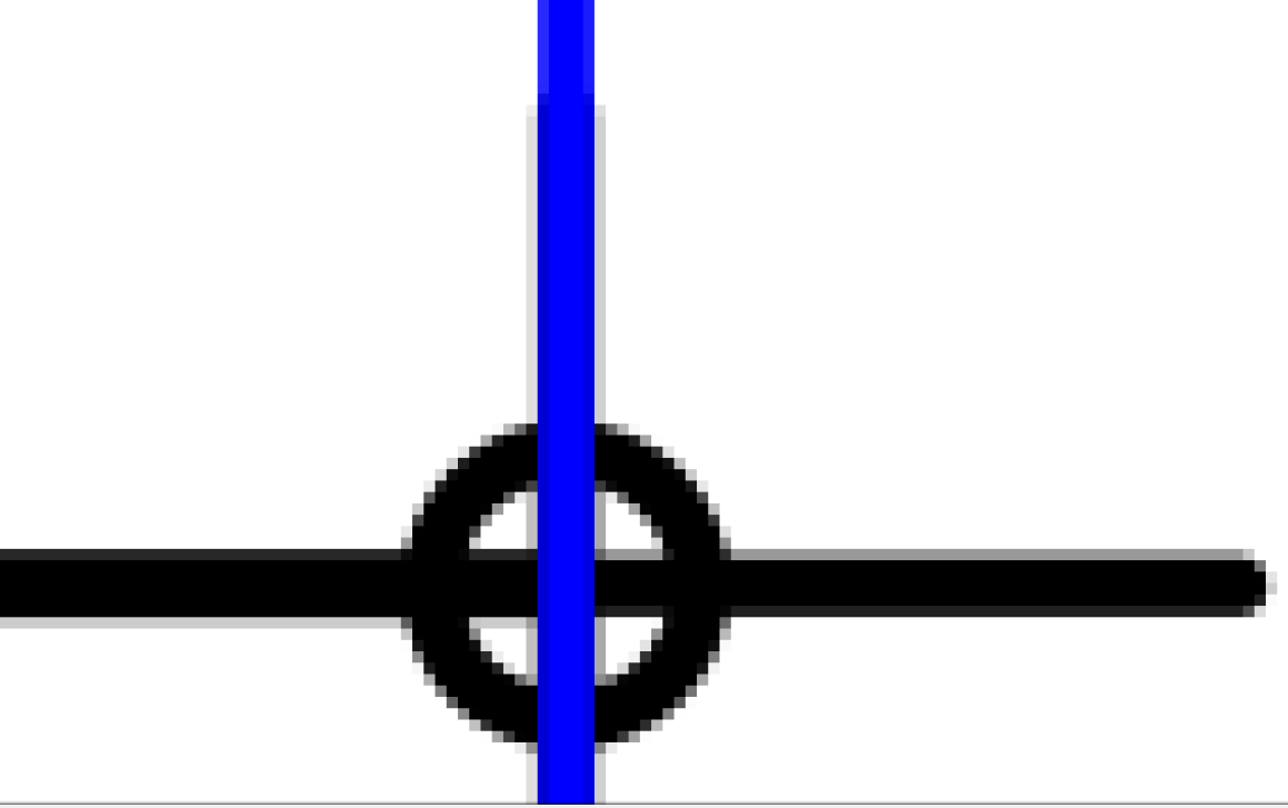

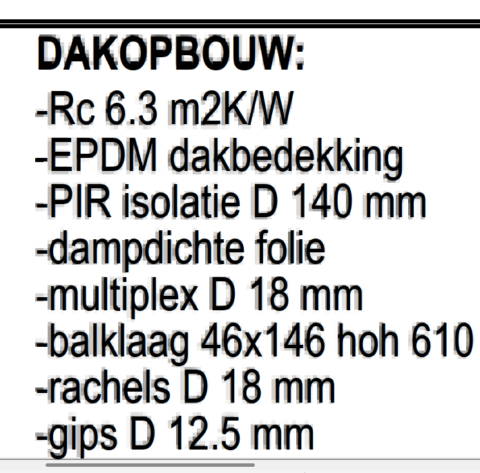

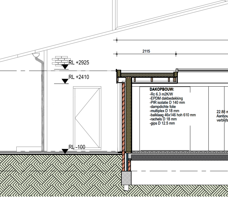

    @chopinregis @theoryshaw Wow guys this is awesome, I couldn't convert my drawings to vector pdf -> very large rasterized pdfs, but this seems to do the trick! (partly)
    After a quick test i came about these things:
    1. you might need to expand the window a bit to see the convert button if not maximized
    2. while my test drawing came out good on the cut fills, which was my main point of error, some text came out weird. Anybody got any tips?
    3. you see these white lines through some of the materials, does anybody have that too?
  • edited May 1
    Hmm okay my bad, seems like everythhing is still a rasterized pdf, but more workable. In either case, great tool for fast conversion! saves a lot of time!
