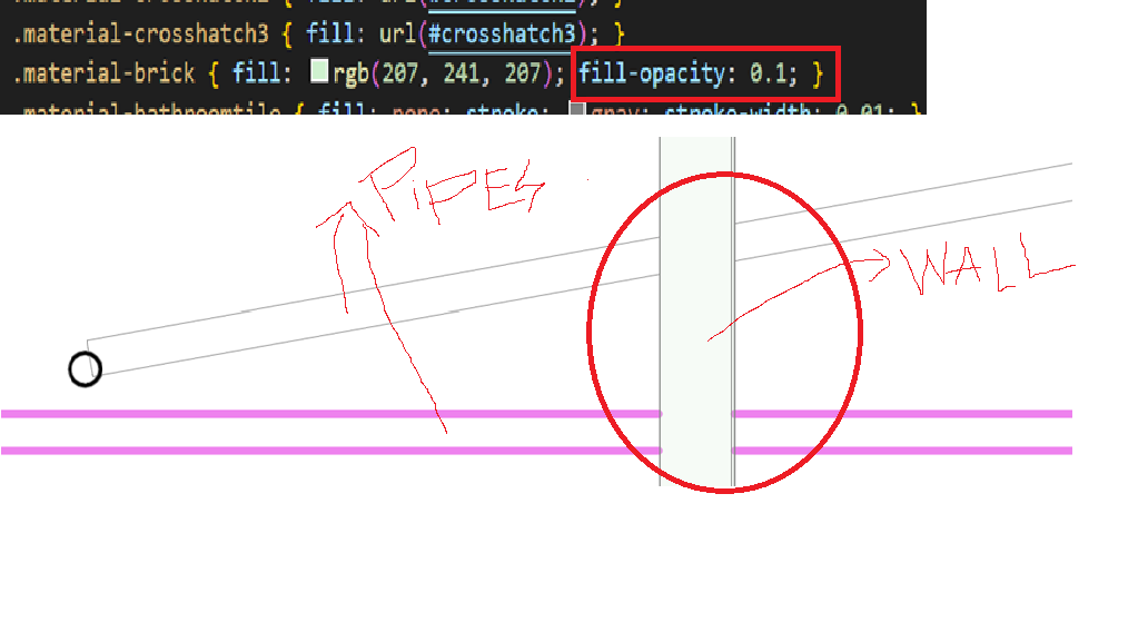

I couldn't figure out a perfect workaround for this, but I think I found the idea of it.
If you can somehow change the opacity for the fill colors of the wall and the column, the column's outlines are displayed.
Configuring CSS settings will do this, but I don't know much about how to manipulate...

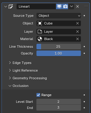

From experience N layers is better and offers more granularity. Something like an integer value, higher draws on top of lower. eg I may want cables inside a wall to be drawn on top of columns and both on top of walls.
A nice feature, too is to be able to define an "occlusion" range to display elements through other that do not cut the camera clip plane. Similar to what Line Art has . This however requires setting up the projector to work in several passes and complicates the computations (AFAIK).
When an SVG file is created with BBIM, it would be ideal if the layers of IfcWall are located under IfcColumn.
Brilliant!.. that's the way to do it!

Yes, that seems like it would work too, but adding
z-index
to the default.css, didn't seem to work, for me.One drawback of the transparency approach, is that it exposes the wall joints in the drawing...
