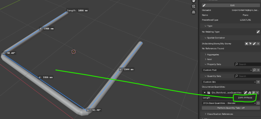

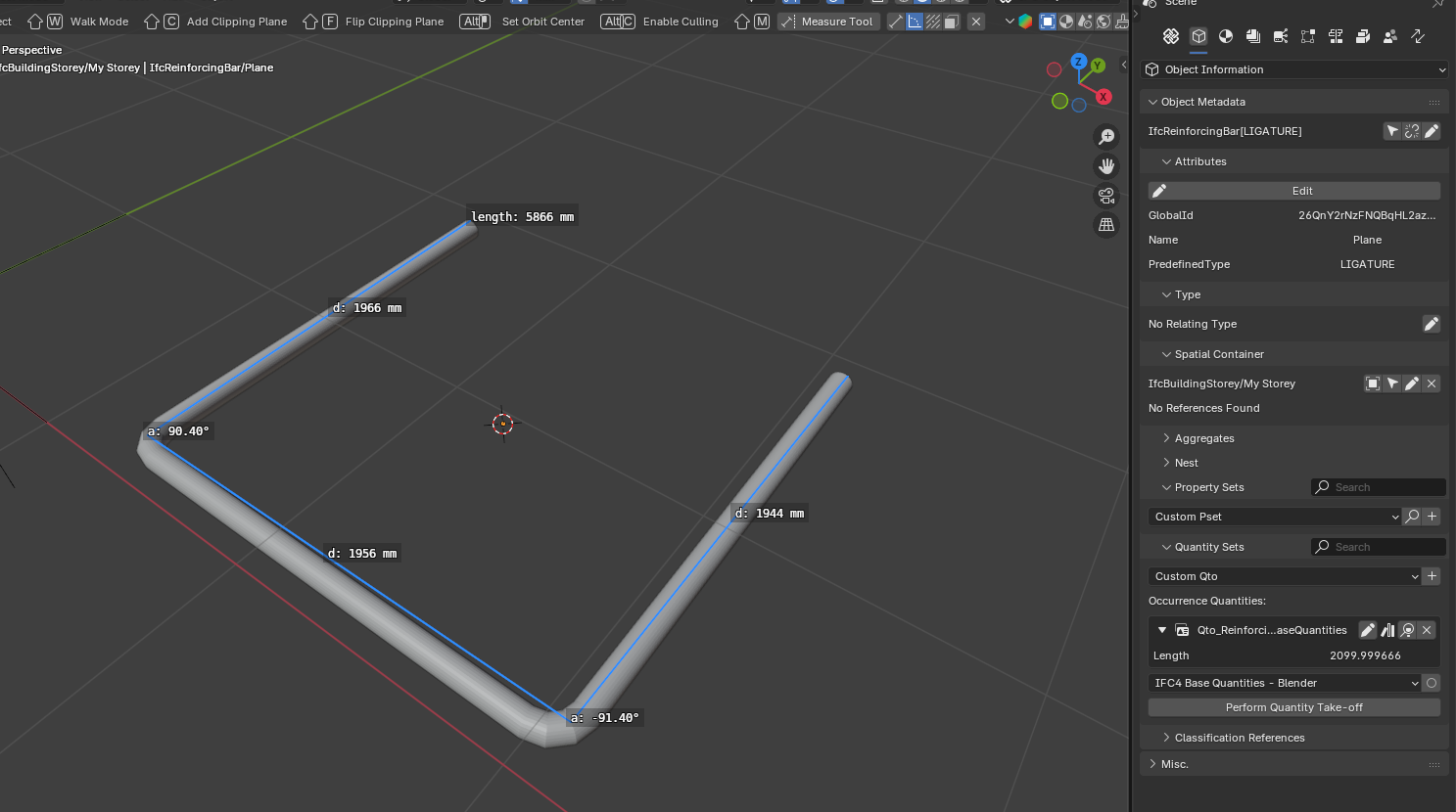

How to create a rebar length QTO
@sahrul
Looks nice, care to share a bit more about the "how to" ? ;)
Thanks

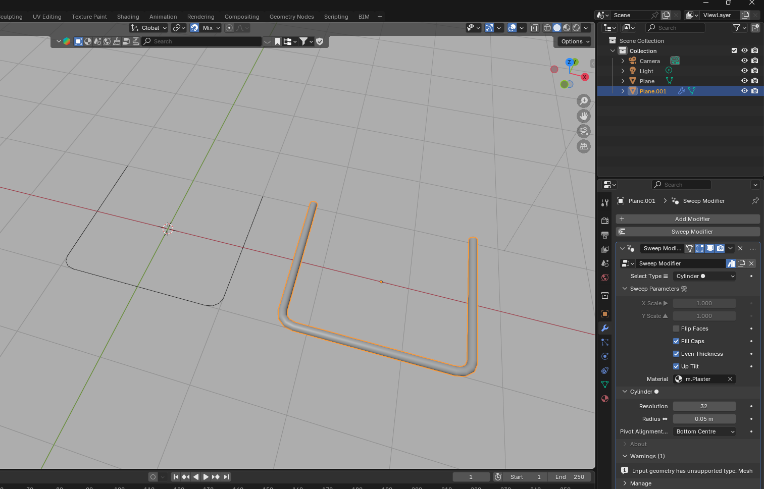

edge to Sweep Modifier
Not yet supported, unfortunately.
https://github.com/IfcOpenShell/IfcOpenShell/issues/3496
"Is it not possible to get the length value of a sweep profile made from geometry nodes?"
@sahrul
it looks like sweep modifier is a paid addon and I can't test it right now, can you preserve the path after you save it as an ifc element?
even when you close the model and open it back again?
thanks
The model is broken like a regular mesh
@sahrul
OK, you don't measure the actual length of your reinforcement bar, but its overall dimension ;)
