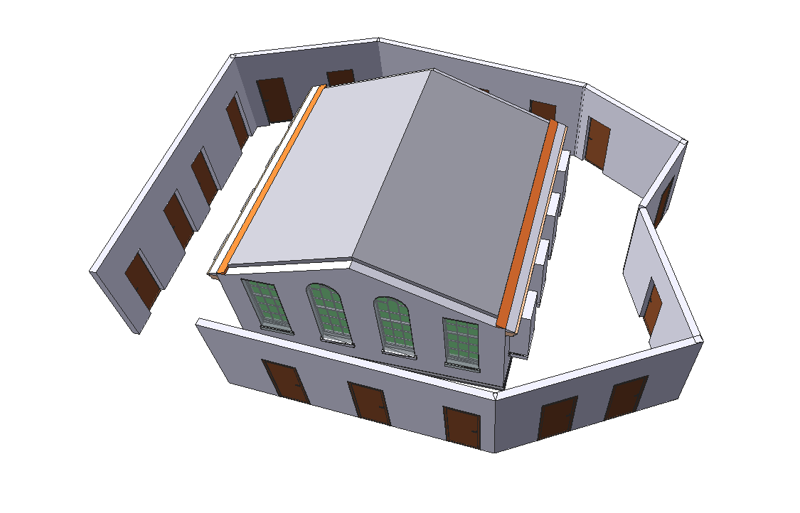

  • Very neat!
    I was able to load a sample file:
    Created a wall with window and door, saved the new file and open it in BIMVision, where it looks all good:
