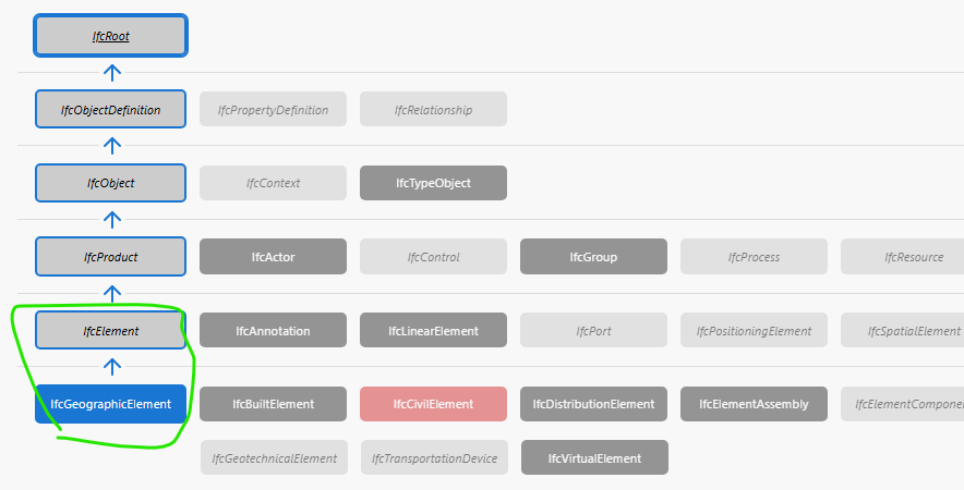

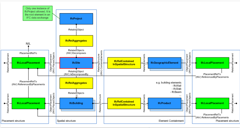

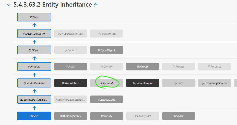

  • @arunarchitect said:
    What is the difference b/w IfcGeographicElement.TERRAIN and IfcSite, Can I make an EarthworksCut in IfcSite. in this file I have assigned IfcSite to this geometry. How to make amn Earthcut here, do i need to duplicate this geometry and assign t as IfcGeographicElement to do so?
    Please check IfcSite page.
    Roughly speaking IfcSite is a spatial element, whereas IfcGeographicElement is an element and is located on a different branch of the tree
    See if this diagram (in the same page) might help:

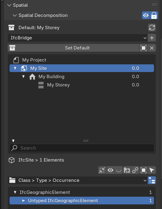

    In Bonsai IfcSite sits between IfcProject and IfcBuilding (as default) defining the Spatial Decomposition of your model.
    Your IfcGeographicElement.TERRAIN therefore is located in IfcSite, like this:
    arunarchitectMassimoatomkarinca

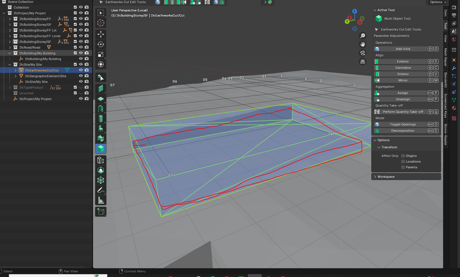

  • edited July 4
    @steverugi said:
    good point, in this case you need to edit the void defining the cut and adjust its vertices
    for sloped terrain is there any better idea to get the exact earth cut volume
