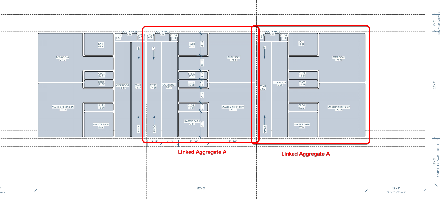

Recently did a programming study for townhomes--could have used linked aggregates to contain the IfcSpaces for each repeating townhome.

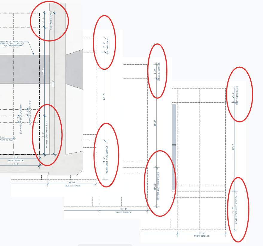

On the same project, if linked aggregates worked with IfcAnnotations, I could have repeated this setback text across these 4 different drawings...that is, change one annotation, they change on all drawings.

just curious: what is the practical use case of having IfcSpace inside an aggregate, or annotation?
