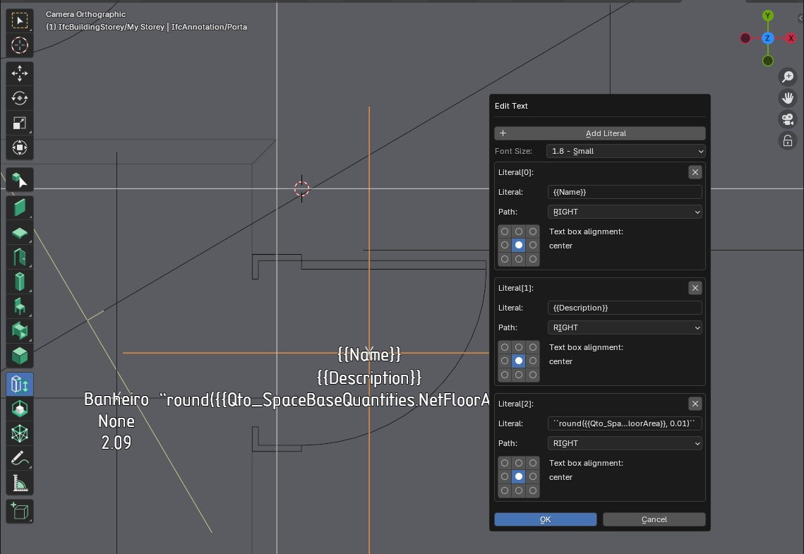

I am trying to edit the text of a DoorIFC but when I edit one door the other entities also change...I need to edit this only text. For exemple I need to remove the area information

Maybe because the properties are controlled by the type...try to create a new type
@Massimo said: Maybe because the properties are controlled by the type...try to create a new type
This is right if you want to edit only this one doors text you need to create a deperate tag (you can duplicate this one) and then change the values
Alternatively you can edit the 'name' or 'description' in the door attributes and that will reflect on the tag individually
Thank you. I will try
@Ace said: @Massimo said: Maybe because the properties are controlled by the type...try to create a new type This is right if you want to edit only this one doors text you need to create a deperate tag (you can duplicate this one) and then change the values Alternatively you can edit the 'name' or 'description' in the door attributes and that will reflect on the tag individually
