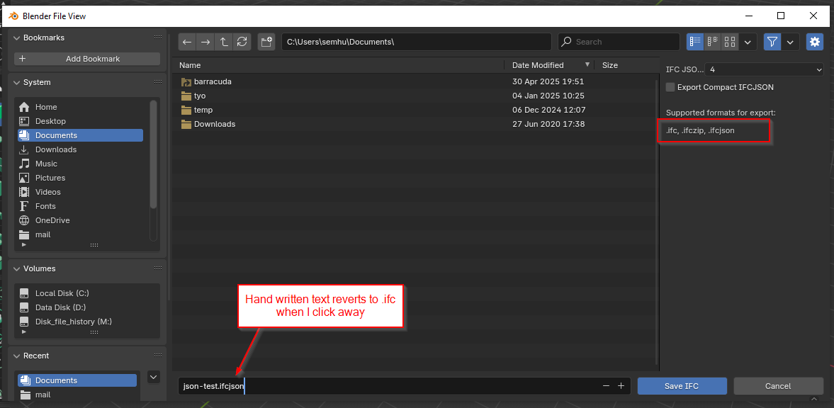

I am trying to export to ifcjson and ifczip formats from Bonsai.
I am choosing File -> Save IFC Project as....
In the save dialogue I can see Supported formats for export: ifc, ifczip, ifcjson
But when I try to manually overwrite the .ifc
file extension to .ifczip
or .ifcjson
it automatically switches to .ifc
when I click away from the file name filed. I also tried checking the box next to Export Compact IFCJSON
with no luck. I am getting standard IFC file saved every time.
I did not find .ifcjson in File -> Export options.
Could someone help explaining how to save to ifcjson? I tried to search around but found only out-of date discussion from 2022.
I am using Bonsai 0.8.2
Tom
