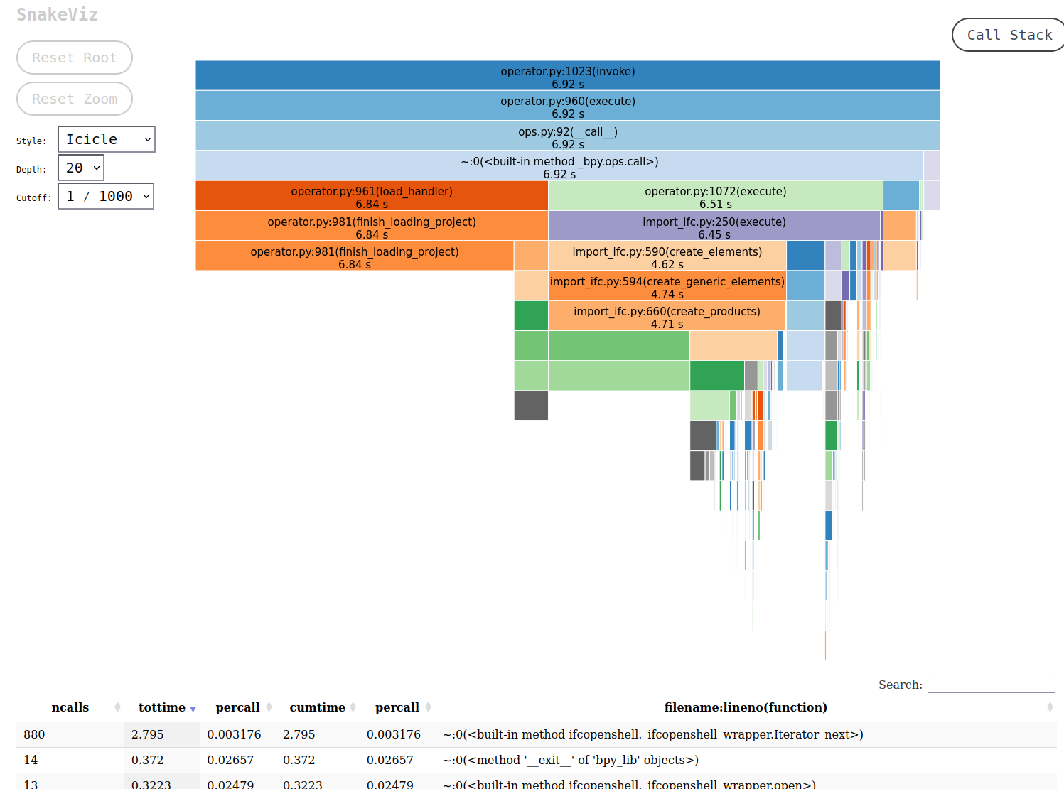

  • Ooooo...
    Very easy.

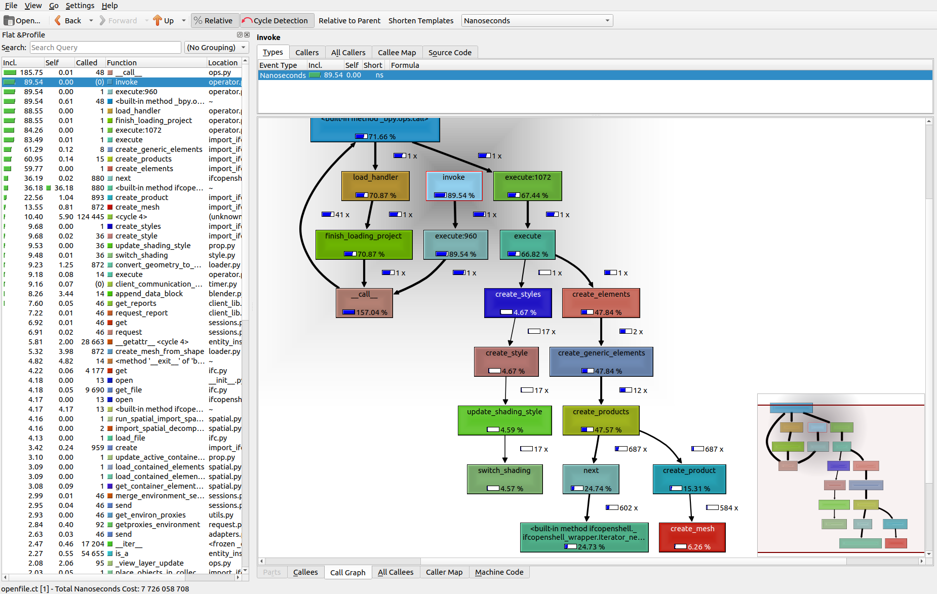

    Install add on, quick capture as I open my project file. Save it, Then use snakeviz for a nice icicle graph (what? did flame graph get trademarked or something?):
    Or alternatively, use pyprof2calltree and open it in kcachegrind which is pretty hardcore:

    Well, I really like the graph and the color choice of the addonprofiler :)
    I can see that Bonsai would start much faster - if we could get rid of all these +.py parts of Bonsai ;)
    But what does it tell to a developer, can you see already something wrong ?
