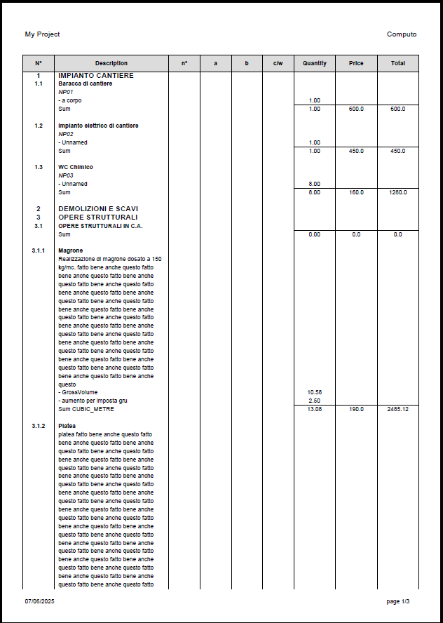

Here a little preview of the output:
Very useful and clean output, thanks!
Script updatated with cover page :)

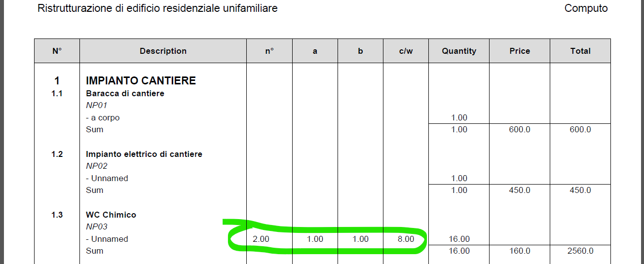

To fill the "n°, a, b, c/w" columns we could evaluate the Formula field in the IfcQuantity:
In this example the Formula was filled with this string:
2*1*1*8
I was also thinking to add a check to verify if the output of the formula evaluation was consistent with the value. What do you think about this usage of the available attributes of the cost quantities?

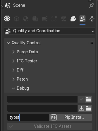

If you want to test it you have to install typst from
Quality and Coordination -> Debug -> Pip Install

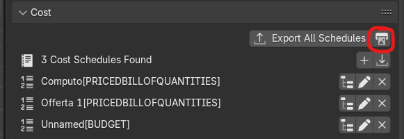

:And the function will be available here:
